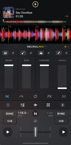

When I started using DJAY, Neural MIX was working great but overtime it started to fail. I don’t know if it’s a software update issue or I started to use more and more and noticing inconsistences. For exemple, I will upload a video with a example of bad sound separation.

When I turn off the voice knob on the last 4 bars it cuts more than that.

In my video, you can see a 16 bar loop and in the last 4 bar’s are with some-sort of vocals. In the beginning of video you can hear it but after I turn down the vocal knob, on the last 4 bar’s the sound will change instead of remain as the first 12 bar’s.
I’m expecting from DJAY to isolate only the “vocals” from last 4bar and leave the drums and harmony like in the fist 12’s bar.

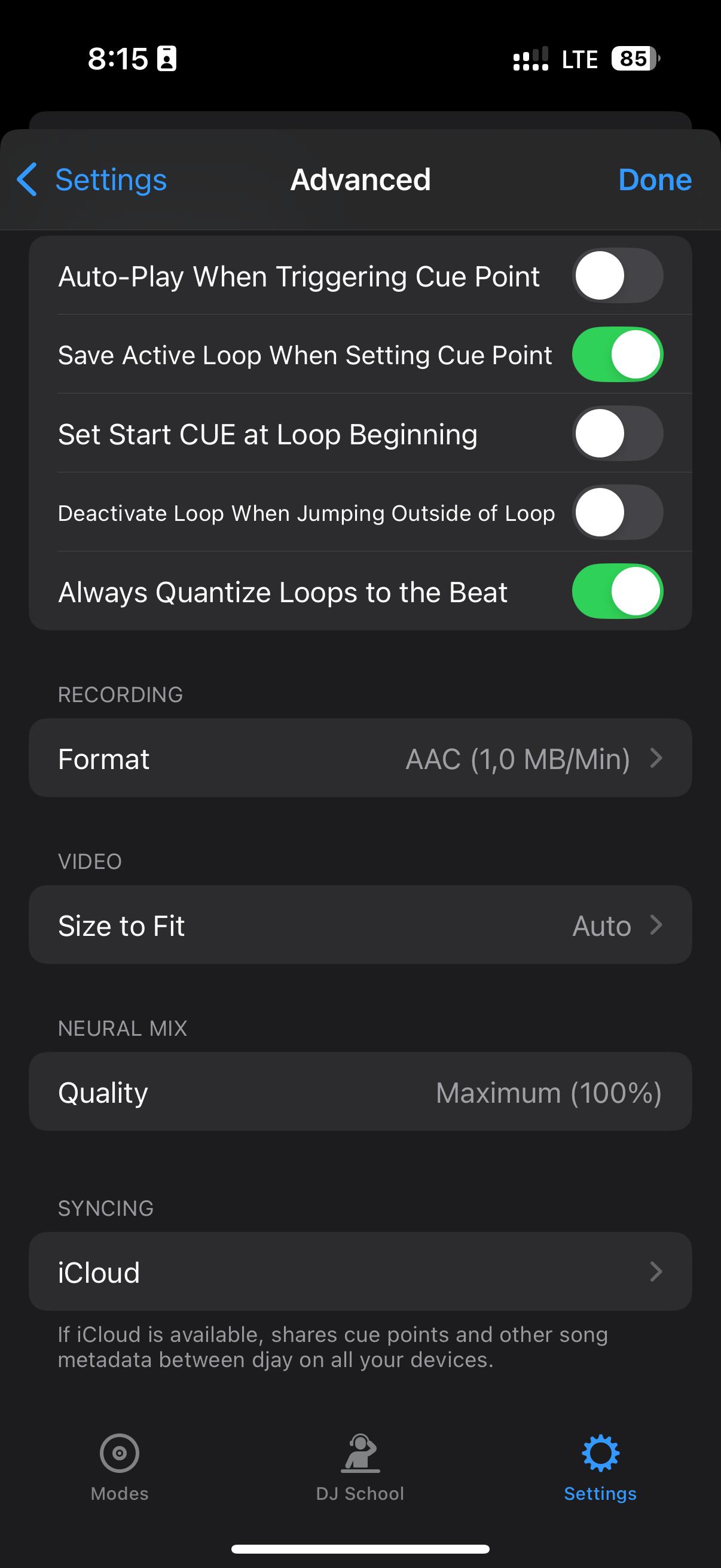

In the meantime, can you please navigate to the djay Settings>Advanced and confirm what your NEURAL MIX Quality is?
Sure, I also checked before posting. It’s 100% for both.
Thanks for confirming @Gabi0110. Maybe try switching to 4 channel NM volumes and removing the vocal that way?
Nope, it doesn’t make any difference.
I noticed in other songs that the separation it’s made better but still the instrumental it’s a bit affected when acapella is muted.
Thanks for the follow up @Gabi0110. I discussed this with engineering and they explained this is not a bug. It’s simply a limitation of the current realtime STEMS separation technology. Please note this is not a perfect tool that will provide the same results as an original studio separation. Certain tracks are simply more difficult to cleanly separate using this technology. I hope that helps explain what you’re observing. Thanks!
