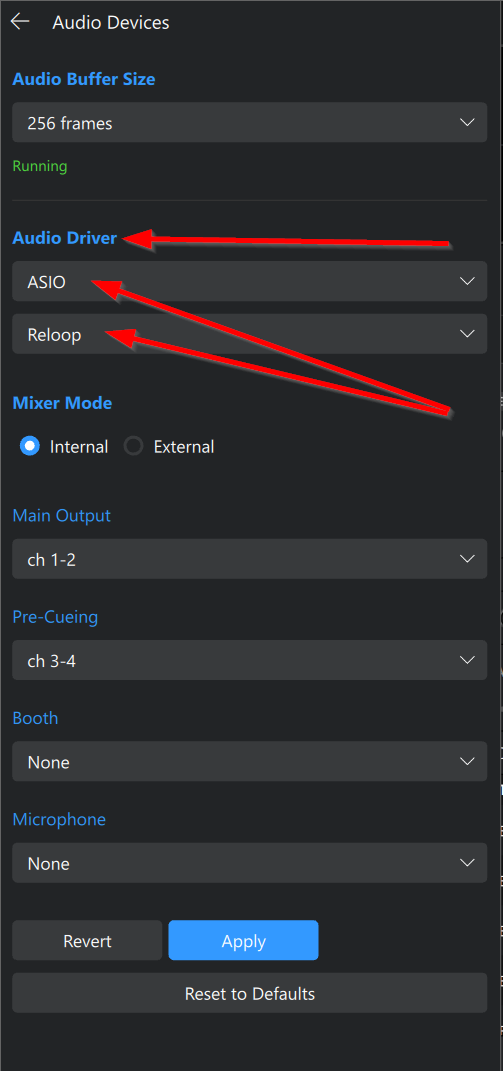

  2. There seems to be an issue with your Audio Driver or USB connection as your djay Settings>Audio Devices don’t look correct. There should be a place to select your Audio Driver as shown below.

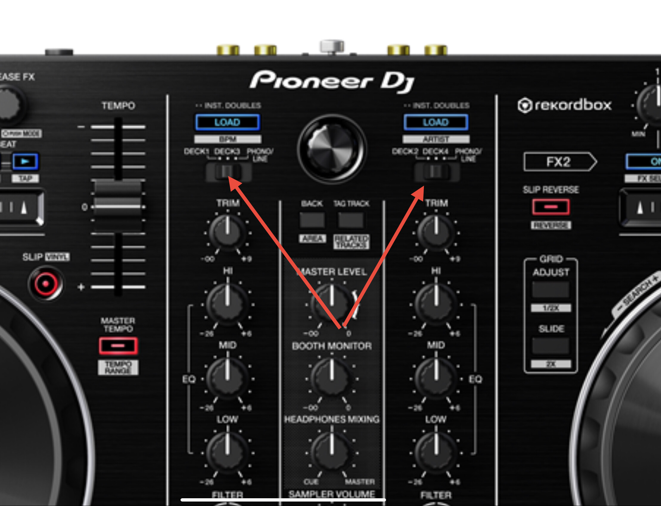

  5. Please make sure the input select switches for both decks are not set to Line/Phone. These should be set to Deck 1 and Deck 2.
