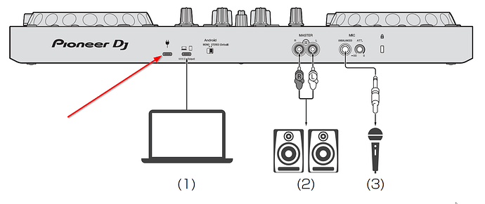

  1. Please start by downloading and installing the latest firmware from Pioneer DJ: Download firmware or software for DDJ-FLX4 - Pioneer DJ - Global
  2. Next, make sure the FLX4 is also connected to power and not running off of USB bus power from your laptop.
  3. Disable Bluetooth on your PC.
  4. Finally, I would try using a different USB cable between your FLX4 and your laptop and also try a different USB port on your laptop. Do not connect through a USB Hub or and USB connector adapters.

I connected external power to the FLX4 and I used a different USB cable and USB port.
I turned off Bluetooth.
Result: no change.
