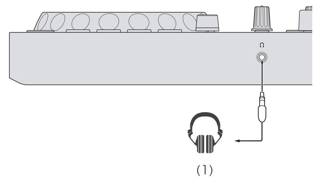

Hi @chonger.mix, welcome to the Community! I recommend that you connect your speakers to the Master RCA sockets on the rear panel of the FLX4 instead of to your computer headphone socket. Then connect your headphones to the headphone socket on the front panel FLX4. This is how the FLX4 is indented to be connected and should solve your audio issues.
