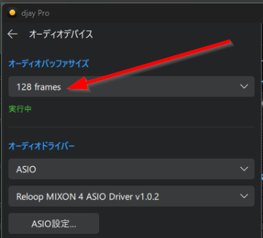

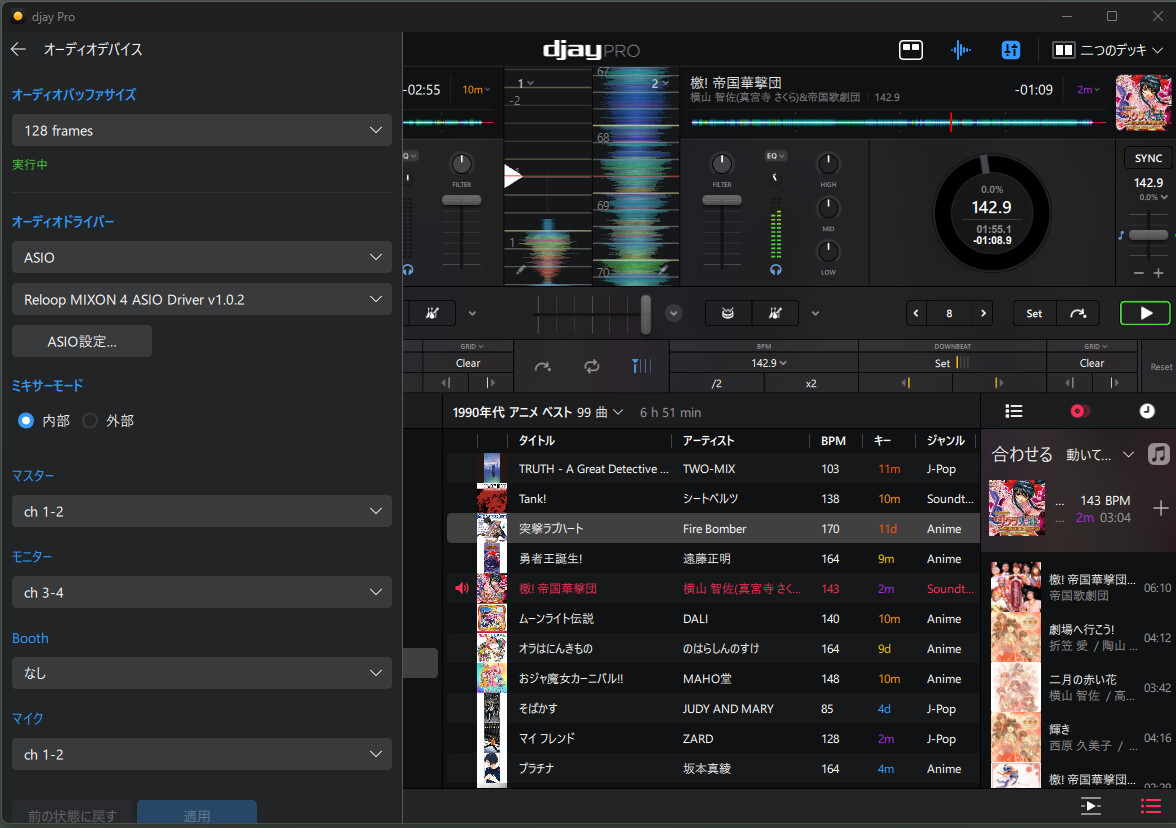

Hi again @megamema, can you please share a screenshot of your djay Settings>Audio Devices window while your DJ controller is connected? Thanks!
Hi @megamema, thanks for the screenshot. Please try increasing the Audio Buffer Size to 256 Frames or 512 Frames and retesting. Let me know if that helps?
Hi,
I understand what you’re saying.
However, I tried changing the buffer size first. Changing it to 512 did not improve the situation.
Even if it did improve the situation, 512 would be fine if you were just connecting normally, but if you use a controller the delay would be too large and you wouldn’t be able to cut in Scratch, so it’s not realistic.
