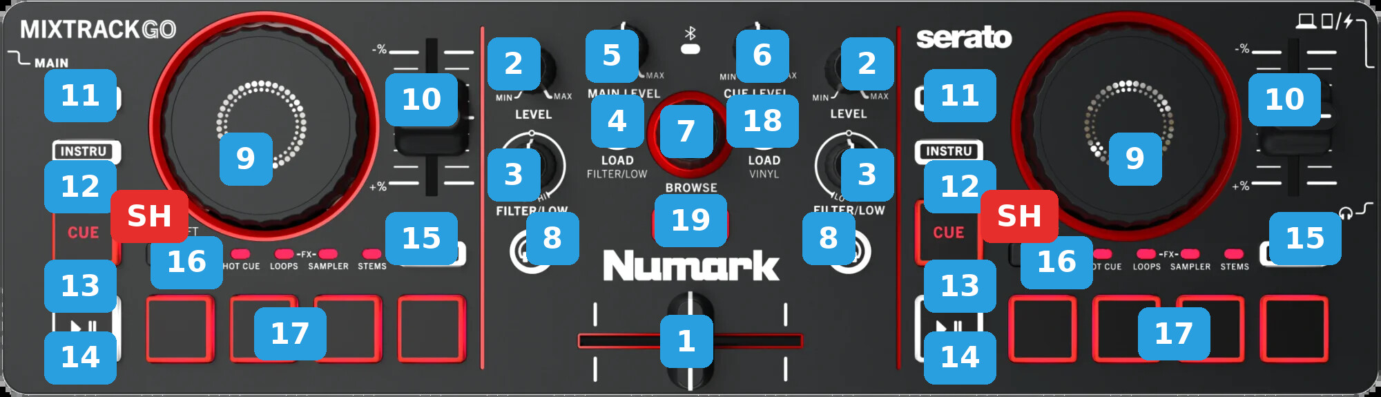

Numark Mixtrack Go - Custom MIDI Mapping
Here’s my personal/customized mapping for the Mixtrack Go.
Numark Mixtrack GO — djay 5.6.7 MIDI mapping
KEY ACTION SHIFT (SECONDARY) ACTION
1 CROSSFADER
2 LEVEL Deck channel volumes
3 FILTER/LOW Filter Mode: Filter. Low Mode: NM Vocal EQ (Custom)
4 LOAD 1 Load track into Left deck. Toggle FILTER/LOW knob mode
5 MAIN LEVEL Master Volume
6 CUE LEVEL Headphone Volume
7 BROWSE Browse library. Push toggles source.
8 PFL / CUE (headphones) Headphones pre-listening.
9 JOG WHEEL Vinyl Mode On: Scratches. Vinyl Mode Off: Nudges Track scrub
10 TEMPO Tempo
11 ACAPEL Acapella (Custom): isolate Vocals, Mute FX off. Same, Mute FX on.
12 INSTRU Instrumental: isolate Drums - Bass - Harmonics, Mute FX off. Same, Mute FX on.
13 CUE Sets a temporary cue point when paused, or returns to it when playing. Jumps to track beginning (Custom)
14 PLAY Play/Pause Automatic transition to Left/Right deck (Custom)
15 SYNC Sync Tempo Reset
16 MODE Cycle pad mode: Hot Cue - AutoLoop - FX - Beat Jump - Stems.
17 PADS HOT CUE: Set/Trigger Hot Cue 1 - 2 - 3 - 4. AUTOLOOP: 8 - 4 - 2 - 1 beats (Custom). INSTANT FX: Instant FX1 - FX2 - FX3 - FX4. SAMPLER (Custom): Jump Size(−), Jump Size(+), Jump Back, Jump Forward. STEMS: Mute Drums - Bass - Harmonics - Vocals. HOT CUE: Clear Hot Cue 1 - 2 - 3 - 4. AUTOLOOP: ½ - ¼ - ⅛ - 1/16 beats (Custom). INSTANT FX: Instant FX5 - FX6 - FX7 - FX8. SAMPLER (Custom): Sampler Slots 1 - 2 - 3 - 4. STEMS: Solo Drums - Bass - Harmonics - Vocals.
18 LOAD 2 Load track into Right deck. Toggle Vinyl mode
19 FADE FX Crossfader FX toggle. Next Crossfader FX
SH SHIFT Hold for secondary actions in the SHIFT column.
Numark Mixtrack GO(SJ1).djayMidiMapping (54.6 KB)
