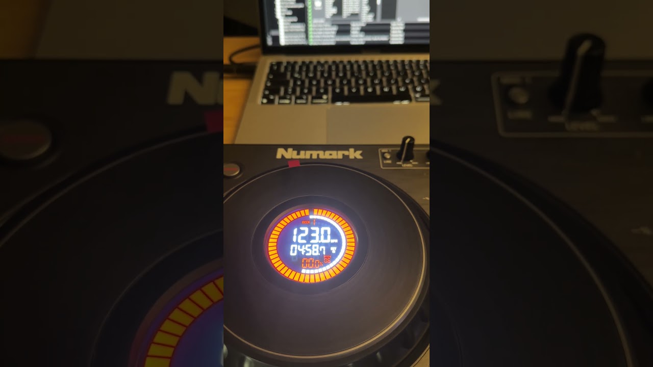

Here is when I press shift while using Djay Pro. As you can see pressing only SHIFT don’t picked up by Djay pro. Yet pressing SHIFT+a button works as expected. Thus remapping and adding additional pad modes manually impossible.

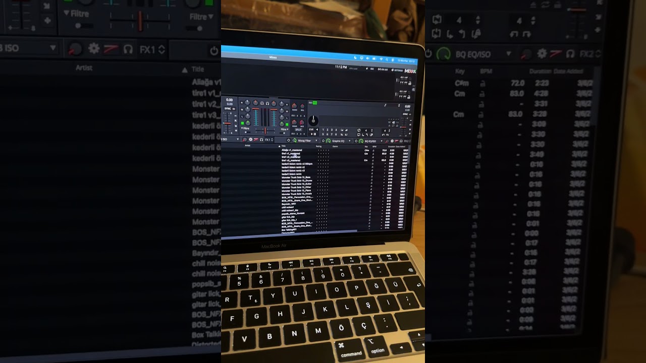

Pressing only SHIFT in VirtualDJ. As you can see It registers as a SHIFT function.

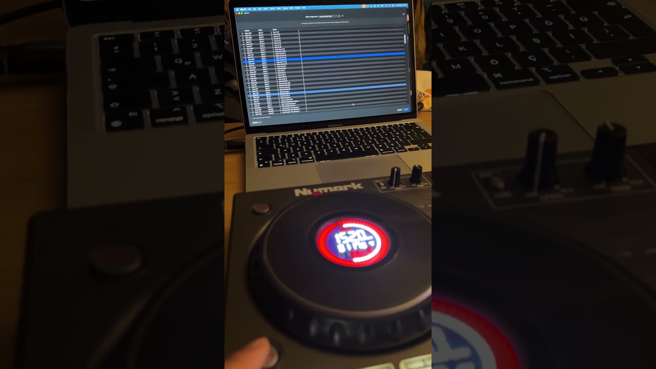

Pressing only SHIFT in Mixxx. Same as VirtualDJ. Sends a data. I am not sure If it is a MIDI data but I can map SHIFT button a function I like.
