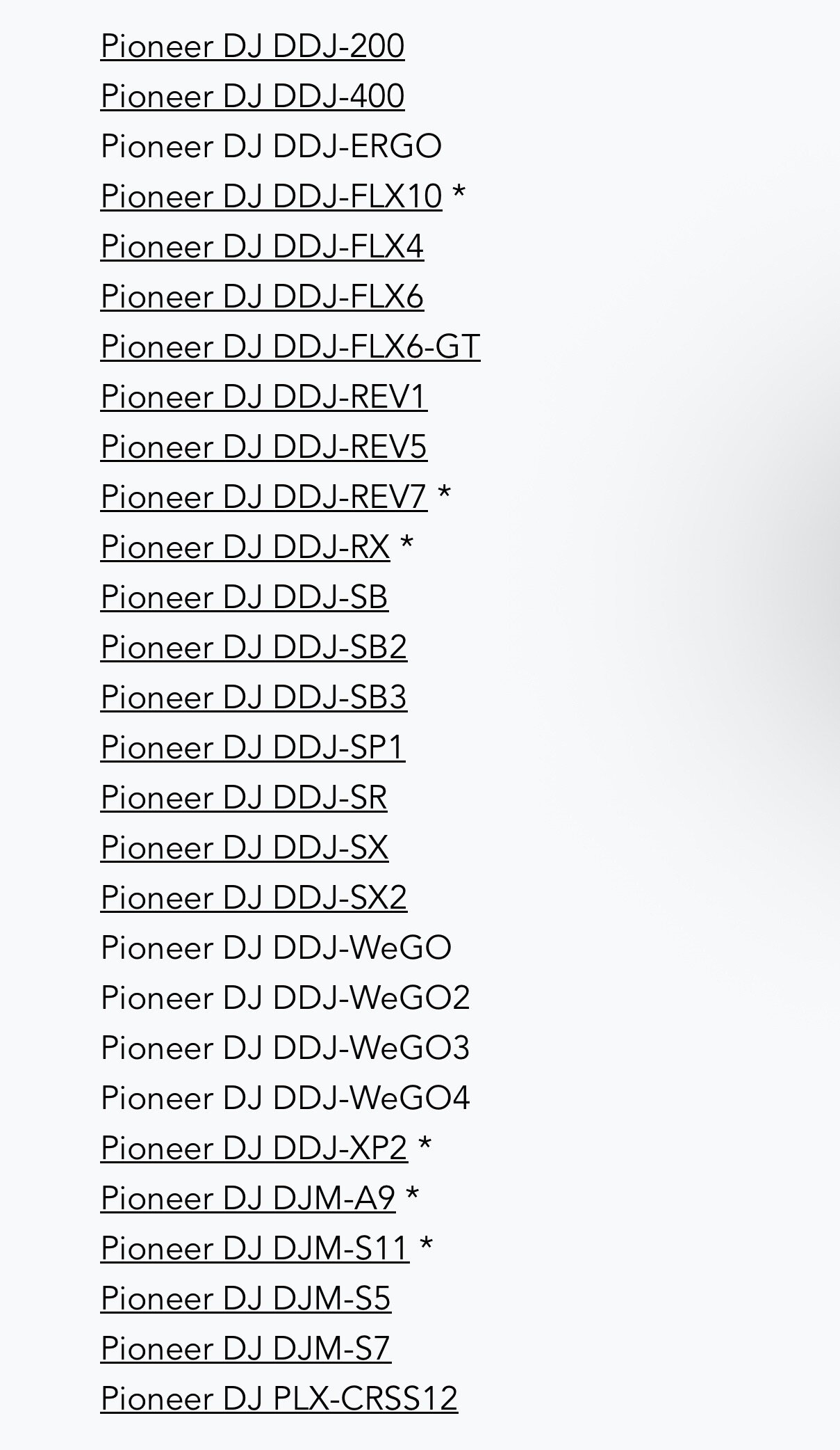

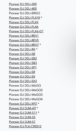

So why is DJ Sz2 listed among the controllers that are compatible with ios version of DJay Pro AI… I don’t think that is cool
@Brown_bkp the SZ2 is not listed as supported for iOS. It is only listed as supported on macOS and Windows. Please make sure you select your OS at the topic of the hardware list.
Oh guess I have been looking at mac Mac-supported MIDI controller i thought it was for iOS but nevertheless, I tried using my Pioneer DJ SB3 on my iPhone over the weekend through my iPhone lightning adapter it doesn’t work the SB3 does not power on have been using this adapter amd work well with flx10 and same pioneer dj sz2 which connects
If you connect the SB3 to your iPhone, you will also need to connect the SB3 to its own provided power adapter. Even when the iPhone is connect to power through the Lightning adapter, it probably does not have enough power to run the SB3 via bus power.
There is no way pioneer sb3 and rev1 has an external power source the player draws power from the usb plugged to a laptop
