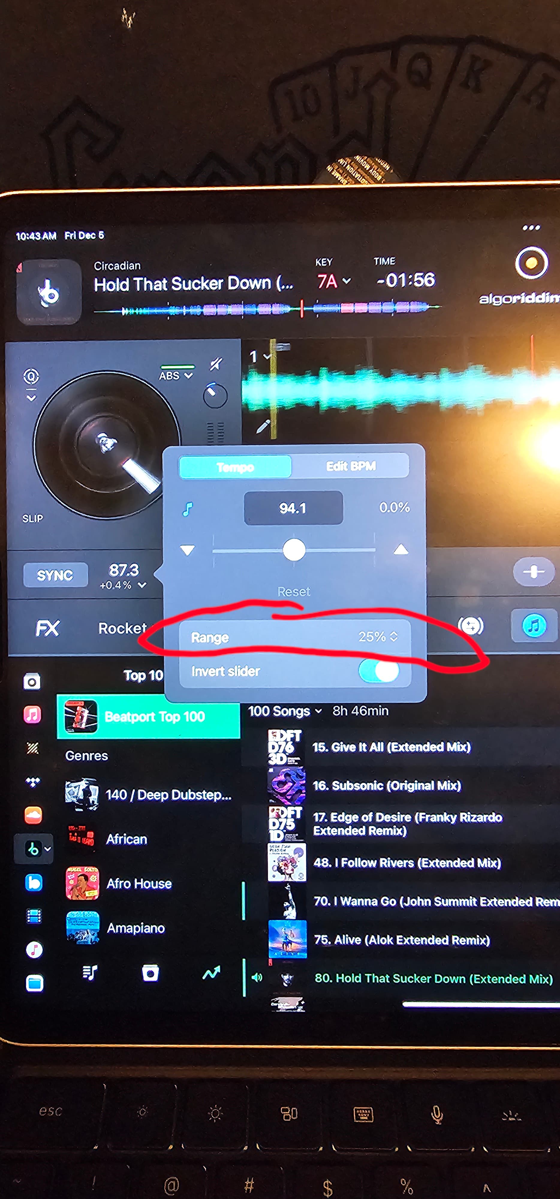

When using this set up, isthere a way to increase the pitch range to beyond +8 and -8?
When I go into DJay’s pitch range setting and choose a larger range, say 16% or 25%, it doesn’t seem to change the range of BPMs I can achieve with my turntable pitch slider.
Am I doing something wrong? Or is this not possible with vinyl DVS?

My question is more about whether there’s a way to use my Technic 1200 pitch slider, but have DJ Pro multiply the effect by somehow changing the picth range %.
For instance, when I change that percentage, it doesn’t seem to change the pitch range I can achieve with my turntable pitch slider.
In DVS, the ‘pitched’ signal comes from your turntable, affected by the physical pitch of your TT. What your asking for is a pitch multiplier for DVS signal in djay. I doubt it will happen but it could, although it will be confusing for others people.
Technics are limited to ±8% (not modified). That’s why I got Reloop RP-8000 MK2 (±50%) or 7000.
