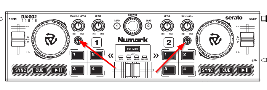

Hi again @dirrogate, while we wait for the hardware team to respond, let’s check some things:
  1. Looking at the DJ2GO2 Touch user manual, I see this hardware has a Mini USB socket. How exactly are you connecting it to your Quest 3? Are you using a direct USB Mini to USB-C cable or some kind of adapter? Have you tried connecting with different cables and/or adapters? It’s possible this connection could be leading to the audio bleed.
  2. Are you selecting the Headphone Cue buttons for each Deck on the DJ2GO2 to send the audio to the headphones?
    a. For example, you should have the Crossfader set all the way to the Deck 1 side, and the Headphone Cue for Deck 2 turned On.
    b. In this scenario only Deck 1 should be playing through the speakers and only Deck 2 should be playing in the headphones
  3. Looking at the manual, it does not appear that this hardware has a Cue/Mix dial for the headphones. Are there any other controls on the side or bottom of the hardware?
Just woke up and replying… @Slak_Jaw
1 - I’m using the original cable that comes with the DJ2GO2 Touch (mini usb to A). For the record it works perfect with a PC running serato lite. I’ve also tried multiple usb A to C adaptors that I know for sure are functioning with my MetaQuest3 both for PD and data.
2 - yes. Doing exactly as you ask in point 2 above .there is definate audio bleed going through the main output from the pre-cue level knob (on both side 1 and side 2 as is labelled on the DJ2Go2 touch)
3 - i understand there is no mix/cue fader or knob. And that the “level” knobs for 1 and 2 are the actual volume faders for the two channels. Yet, it’s the pre-cue level knob (marked cue level) that bleeds into the main output when turned up.
Meanwhile NO output is routed to the headphone socket located on the Right side of the hardware controller. there are no other sockets / knobs on the back, under, or side of this controller.
