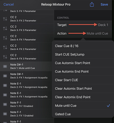

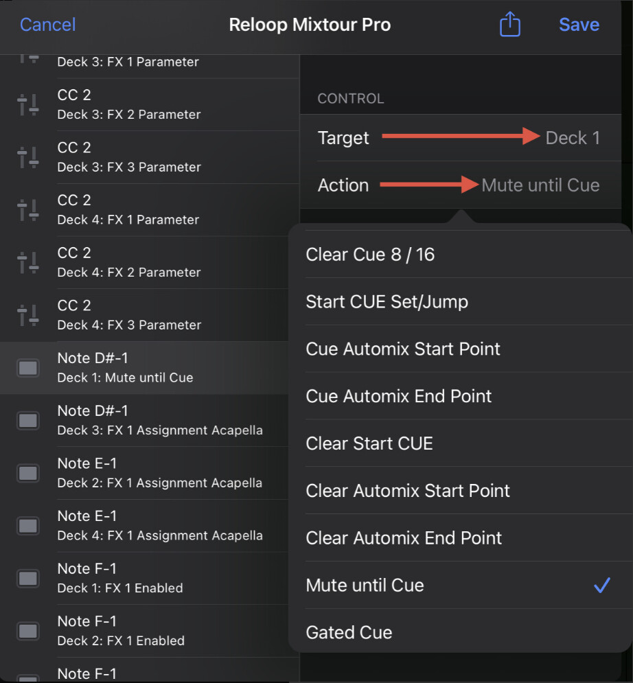

In the meantime. please note that you can custom MIDI Map “Silent Cue” yourself. The MIDI command you’re looking for is found in the CUE POINT PADS (1-8/9-16) section and it’s called Mute until Cue.
For more on custom MIDI mapping in djay, please refer to the linked info below:
