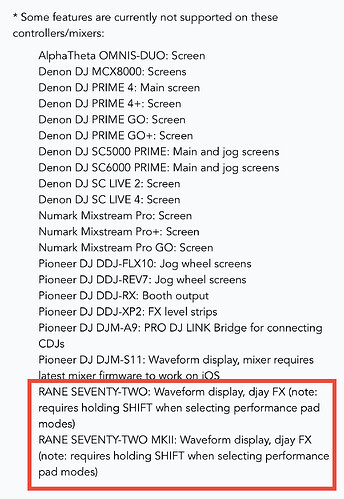

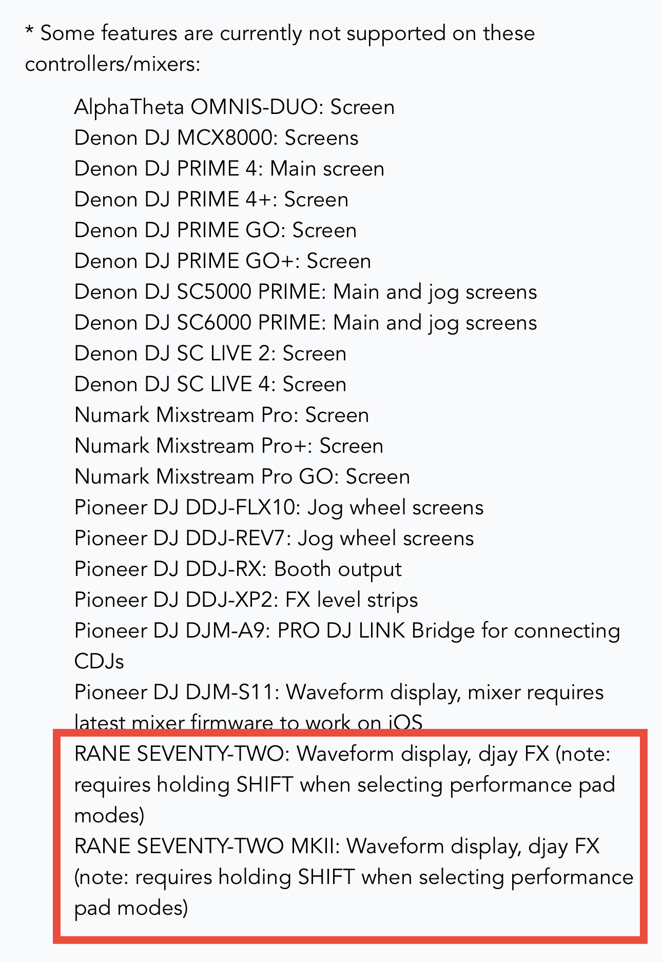

Hello everyone! I want to replace my Numark Scratch mixer with a Rane 72! I’m interested in whether everything will work ok? if I use a Technics 1200/Rane 72 and IOS! I’m only interested in working with an IPAD!
Hi @Polyura,
  1. The RANE 72 is supported on iOS with a couple of limitations: DJ Controllers, DJ Mixers and other DJ Accessories | Algoriddim
  2. We also support DVS on iOS:
