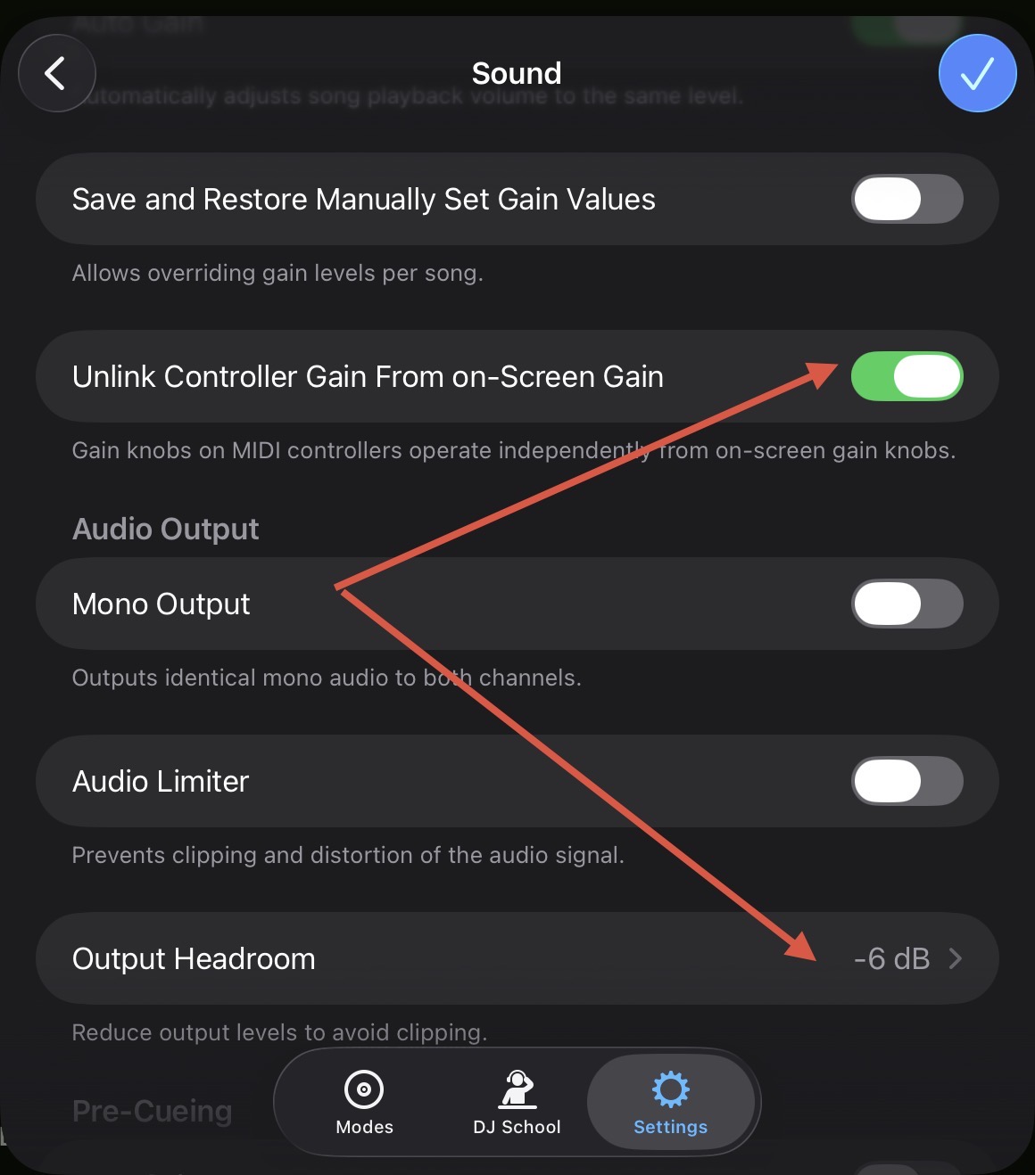

Hi @boabmatic, I recommend you check your djay Settings>Sound and share screenshots of these settings.
  1. I suggest you enable Unlink Controller Gain From on-Screen Gain.
  2. You may also want to change the Output Headroom.
Thanks for the quick reply , I’ve updated my settings to the same as your screenshot . I’ll not be able to test them for a few weeks as I’ll not be back on the Rane One until then.
You’re welcome @boabmatic. Sounds good. I’ll consider this solved for now, but feel free to post here again after testing if you still have any issues.
