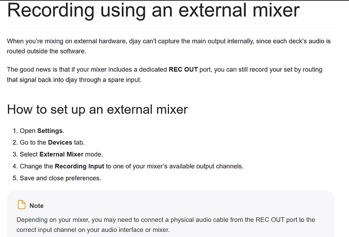

Hi @GECHO, please refer to the linked Help Article below and let me know if that helps.

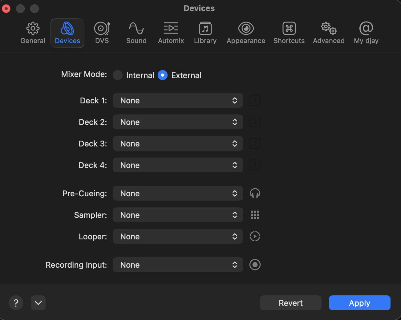

I think you missed the point of External Mixer Mode and took it literal to your gear being external. There are two options within Djay Audio settings where these devices appear it can either appear in Internal or External.
When connecting the XDJ-XZ and XDJ-RX3 they appear under this section and not in the internal section. So when recording the audio it’s completely silent. @PKtheDJ suggested looping the audio back in but Djay does not have a feature for that like Virtual DJ I am looking into an app called Loopback Audio.

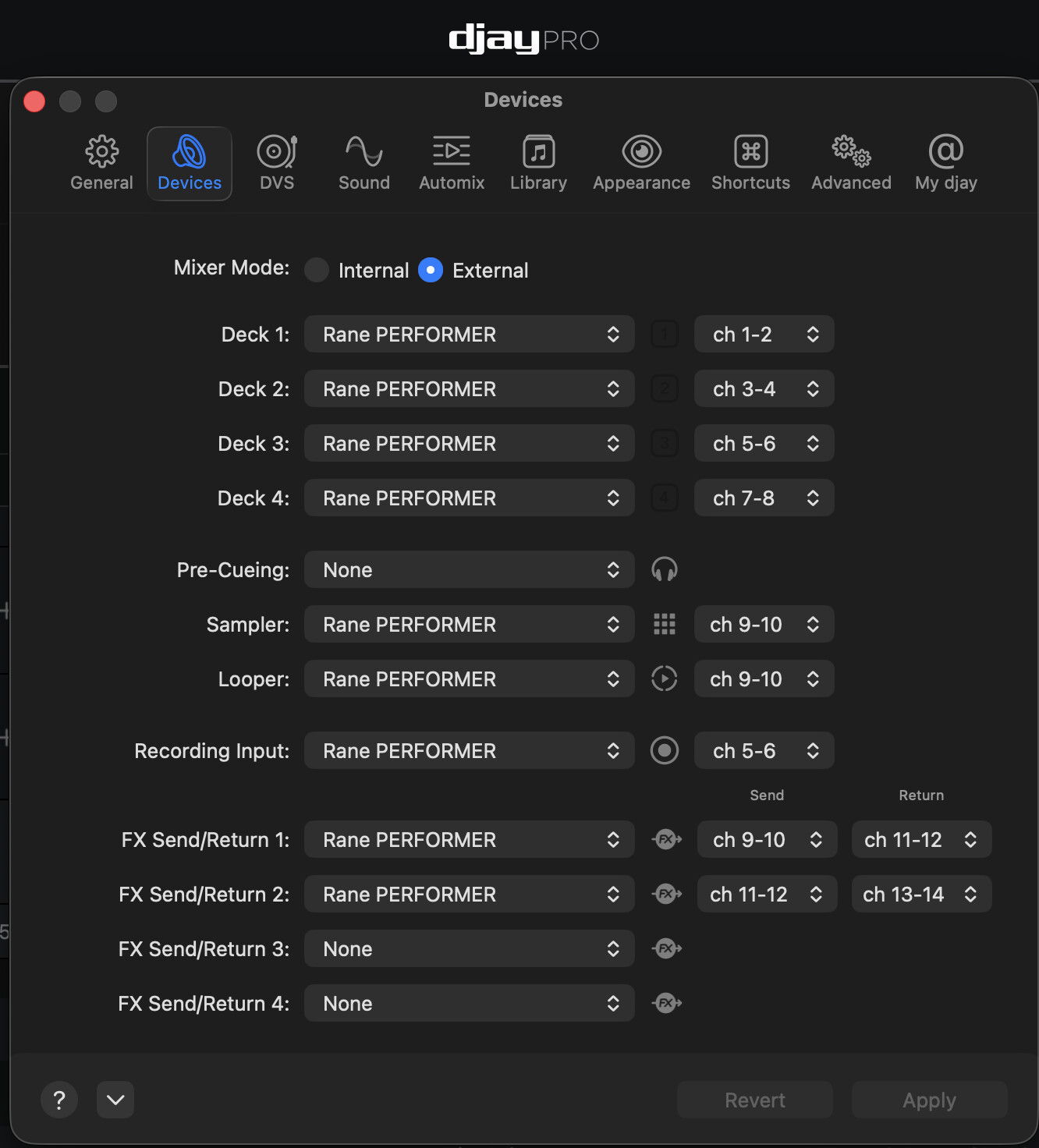

So I just got an update after playing with the RANE Performer. It picks up the mixer as an external mixer but it somehow allows the audio to be recorded. Please check the Recording Input section it uses Channel 5-6.
