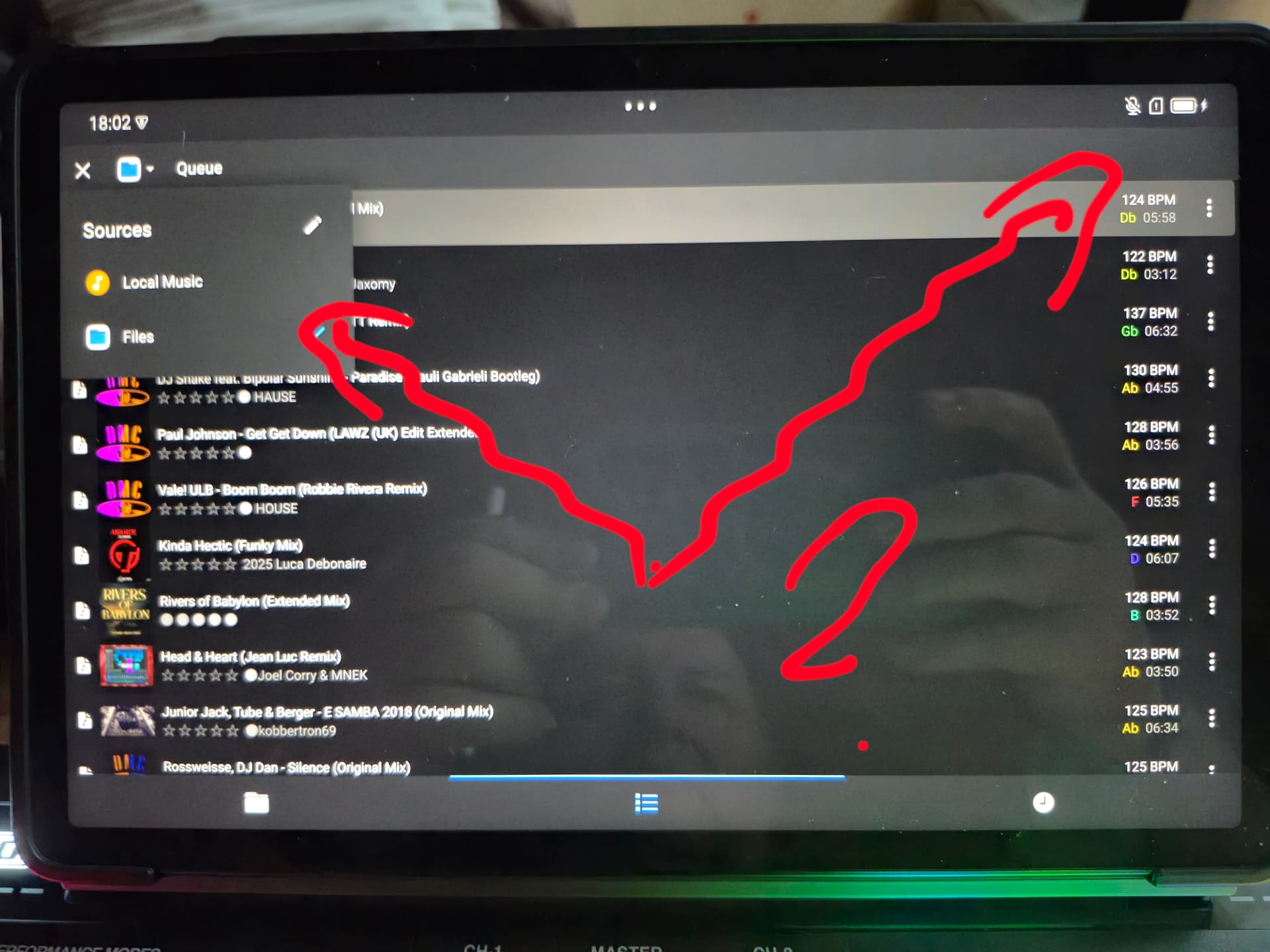

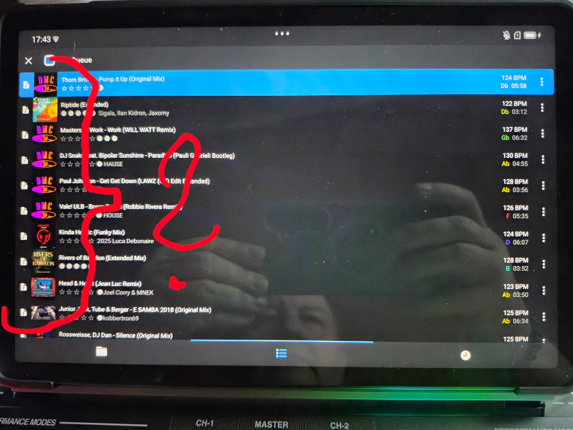

What else is this icon that appears on some lists that don’t exist?
Can you please share a full screen screenshot that contains this icon so I have the full context?
Of course, please
That is simply the icon for music files added/linked through the Files Source. You we see different icons for other sources like djay Music, Tidal, SoundCloud, Beatport, etc.

It’s strange because this tablet doesn’t have an internet connection, these are files from the internal memory from the SD card striming disabled . Rander mp3 to 320 kb/s może za dużo ?

Yes, that icon is for local files not streaming files. Streaming files like Beatport have a different logo.
