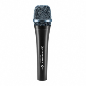

I have the same issue. Trying to connect a Sennheiser e945 with a balanced XLR- cable but it is not recognised by DJay Pro AI. Does this only work with a connected interface or what’s the setup here?

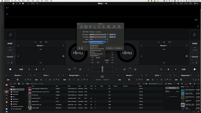

- Can you please a screen shot of your Audio Device Setup?
- Also, what what device are you using (MacBook, iPad, iPhone, etc.?
- What OS version and djay Pro AI version?
- Do you have an active djay Pro AI subscription?
Hey @Slak_Jaw ,
thanks for the quick reply!
Attached my setup in the file.
Running a MacBook Pro 16inch 2021, M1 Max, 32 GB RAM with Mac OS Sonoma 14.0.
DJay Pro AI is at Version 4.1.10 and has a running subscription.
I also updated the firmware on my Mixon 4 to v2218 today.
Thanks and cheers

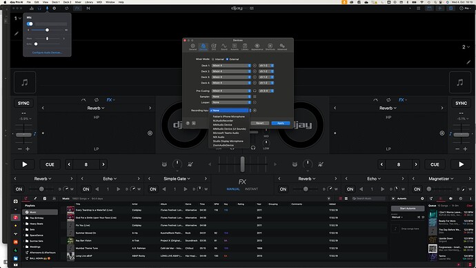

@Fabian_Wiktor you’re welcome. It looks like the Mic channel on the Mixon 4 is not accessible to djay. My guess is that it’s wired directly to the Master on the Mixon 4. Try switching from Mixer Mode > Internal to External.
Tried that, but still doesn’t show up.
Mic normally wouldn’t need a battery or external energy source, right?
Are you using any form of interface or other software?
@Fabian_Wiktor I understand that the mic still doesn’t show up with External Mixer Mode, but try testing it with those settings anyway to see if it works.
@Fabian_Wiktor as for the microphone, some do require external/phantom power to work. The Mixon 4 does not provide this type of power so you definitely need to use a Dynamic Mic instead of a Condenser Mic.
Just tested it, nothing to be heard unfortunately.
The mic is a dynamic mic.
