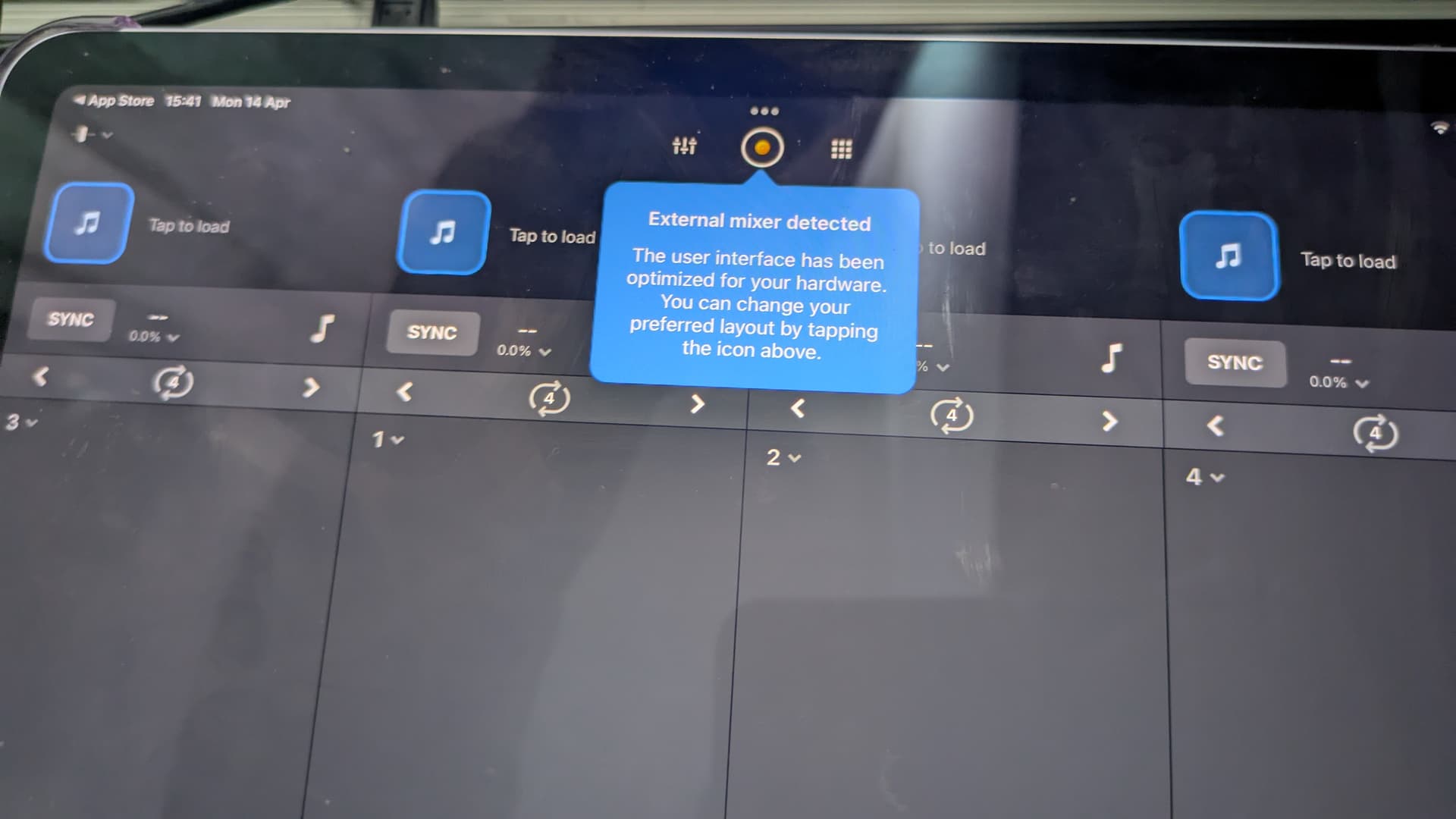

Hey, thanks for your response. Yeah that hasn’t work. I’ve updated iOS, deleted and reloaded DJAY and none of these have worked.
When I plug it in I get the message in the picture but nothing else happens.
Reinstalling DJAY also reset midi settings so I’m using the original mappings that come with the software.
Tried different cables. Really can’t think what else it can be from my perspective except some kind of bug in the software
Also… Just to add that I’ve tried it with a different iPad and it doesn’t work. Also checked Mixon 4 firmware was the latest.
