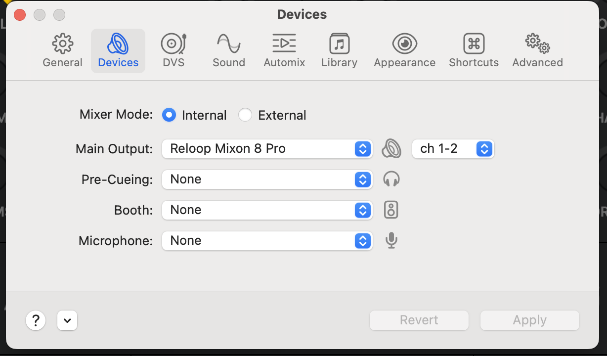

  5. If this doesn’t work, please navigate to the djay Settings>Audio Devices and share screenshots of this page. Thanks!

I tried your setting, it changed something, I can use the tap buttons , but still not 1 channel music on the speakers and the other on the headphone.
I tried in the Device settings with None and Split output. No result that i want.

Hi @boing, within Internal Mixer Mode enabled, you need to set the Pre-Cueing to Reloop Mixon 8 Pro and ch 3-4. You have is set to None right now so no headphone pre-cueing is possible.
It should look similar to this (iOS shown).
