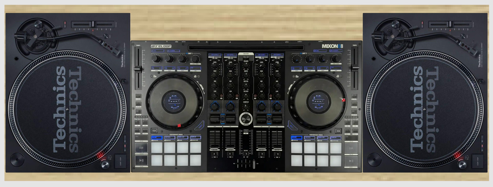

I currently run two Technics 1210mk2, Numark Scratch + Phase. I’m kind of looking to change up my setup somewhat, but limited on space. I think given that I mix EDM, I don’t generally interact with the platters too much. So when using MP3s, feels like it makes more sense to use a controller (to get rid of wow and flutter), and then supplement with the turntables for an occasional analogue track or mix.
I can just about fit a Reloop Mixon Pro in the middle of the turntables, if I change them to battle orientation (not great for EDM though and riding the pitch!).

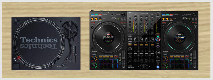

Any other thoughts or input would be great! My other option is to drop a turntable (keep one in non battle style) and pick up a FLX10. Just means I lose the option to mix vinyl to vinyl.
