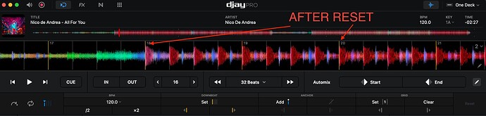

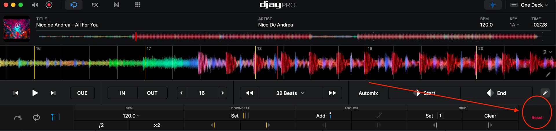

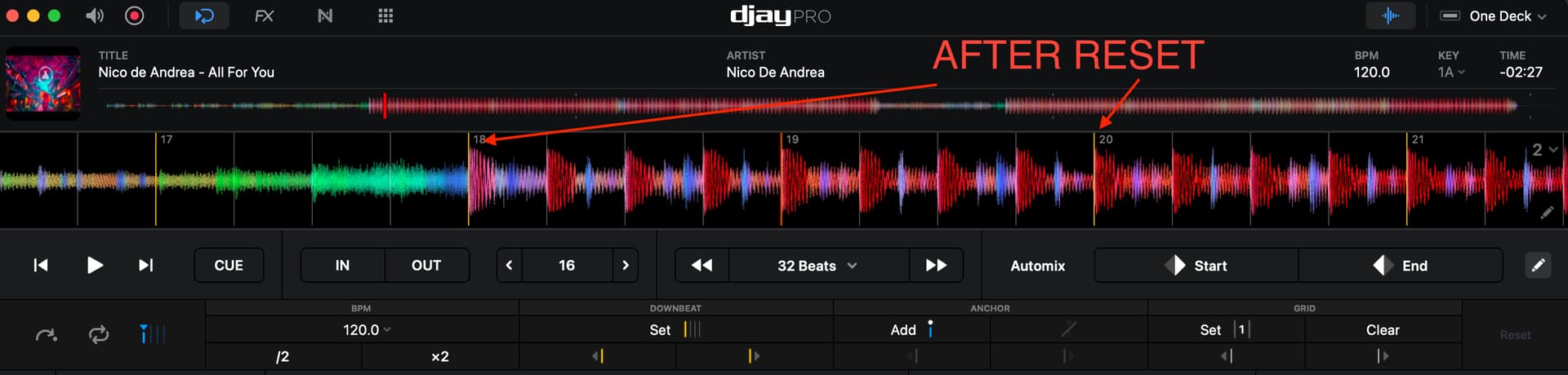

Currently having the same issue - I wonder if Christiaan at Lexicon has a fix for this because Djay is still in beta for Lexicon. See screen shot below of a track after syncing library from Lexicon, then performing “BPM->Restore Analyzed” which I think is the same as Beatgrid “Reset” it fixes the grid which is slightly off.
