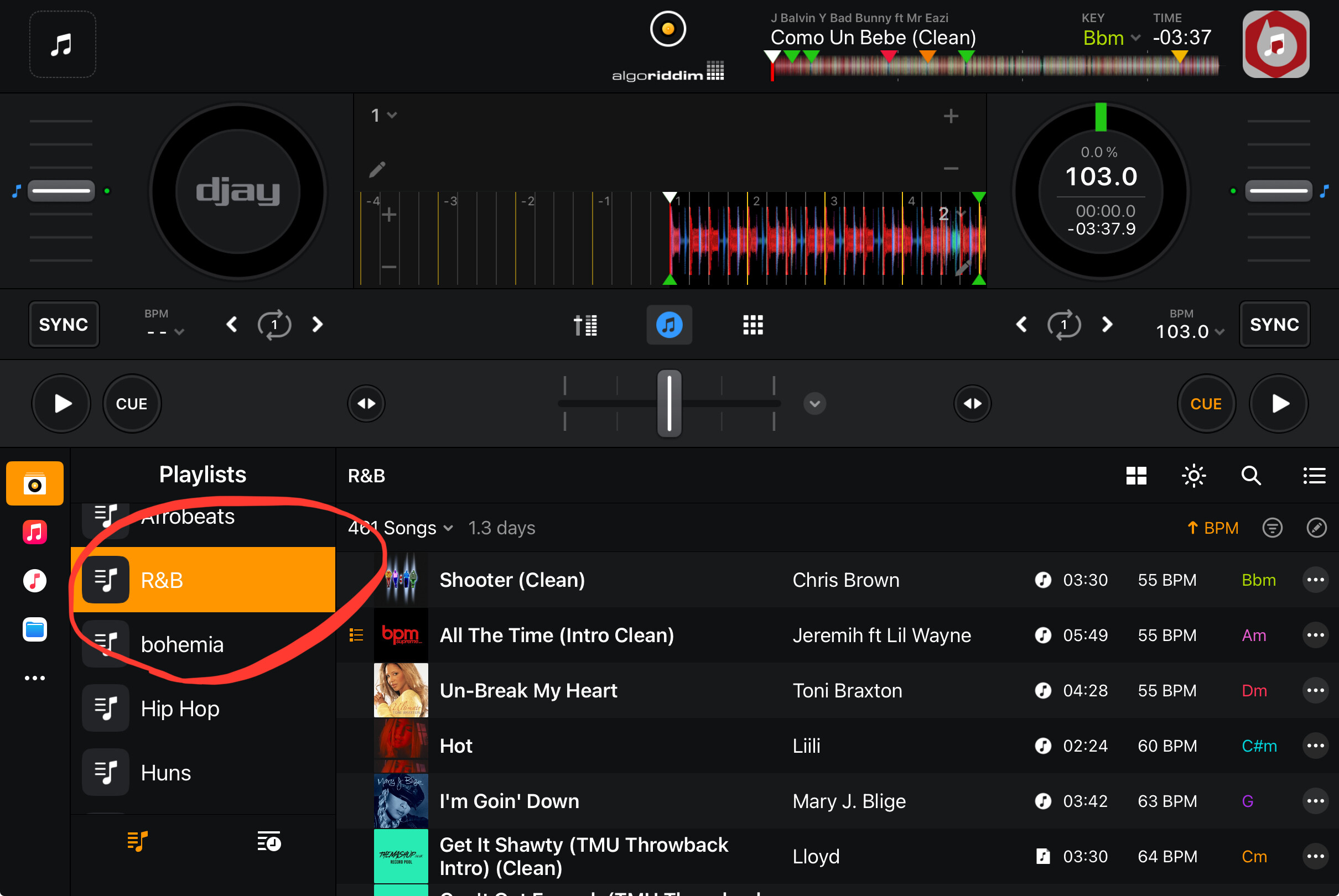

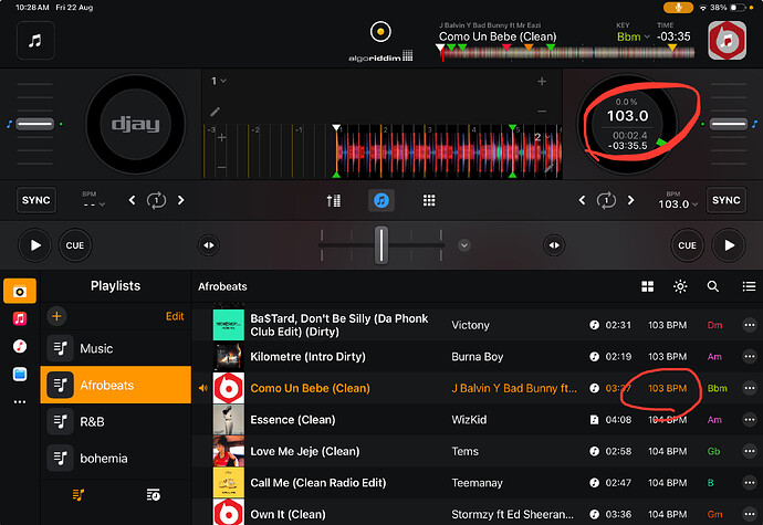

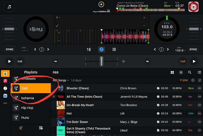

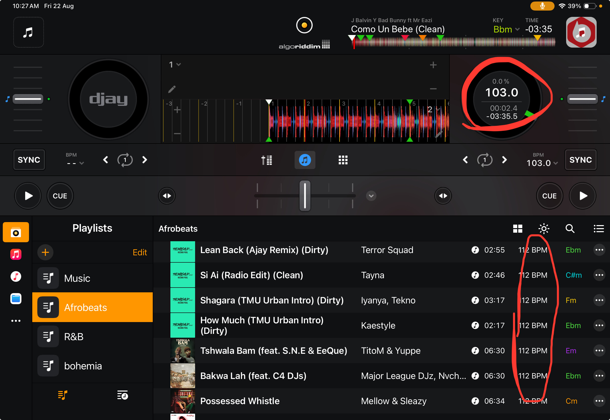

Hey Algo team, when flipping between playlists (if sorted by BPM)
e.g: if I’m in “Hip Hop” and load a 98BPM track then go to “R&B”
when I come back to “Hip Hop” it’s put me at a totally different BPM place in that playlist.
Have been using DJP on iPad M4 at some big venues with FLX4 and this has been wasting so much crucial time scrolling just to get back to last selected song, it’s honestly so frustrating for this kind of multi genre workflow.
Here’s some screenshots
01)
Track loaded 103BPM from Afrobeats Playlist
Browsing to a different playlist (R&B)
Returning to Afrobeats Playlist to find a completely different 112BPM placement
