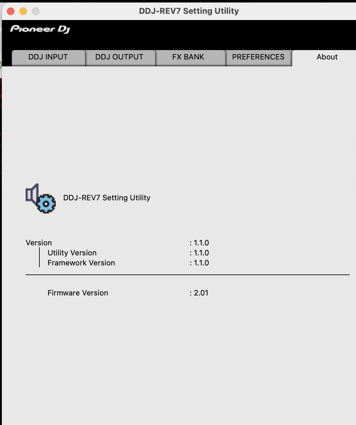

Hi @CALI68, thanks for the description of the issue. As @MichaFalki suggested, please share the complete details for your setup.
Hardware Firmware Version:
  1. Since this sounds repeatable, can you please capture and share a short video of the issue to help clarify what’s happening?
  2. Have you installed the latest REV7 firmware and drivers from the Pioneer website?
  3. How exactly are you connecting the REV7 to your device? Any USB Hubs or Adapters?
  4. Have you tried a different cable or USB port on your device?
Ensure that you have DDJ- REV7 Utility DDJ-REV7 Setting Utility for Mac - AlphaTheta Help Center install and open when running Djay pro.
Thanks for sharing @Kevnice
I believe this issue began immediately after updating djay Pro through the Automatic Mac App Store yesterday. Prior to the update, I had never experienced this behavior. Since updating, the waveform inside the DDJ-REV7 jog wheel displays often remains blank for approximately 20–30 seconds after loading a track, even though the main waveform on the Mac appears instantly and playback is completely normal.
I am running a 2024 MAcbook Pro with the latest OS: Tahoe 26.5.1
The Version of Djay Pro is the latest: 5.6.6
Pioneer DDJ REV 7 with latest software update.
Thank you for the response, I have the latest installed…it has been working perfectly up until yesterday.
All requested info has been provided. Thank you!!
