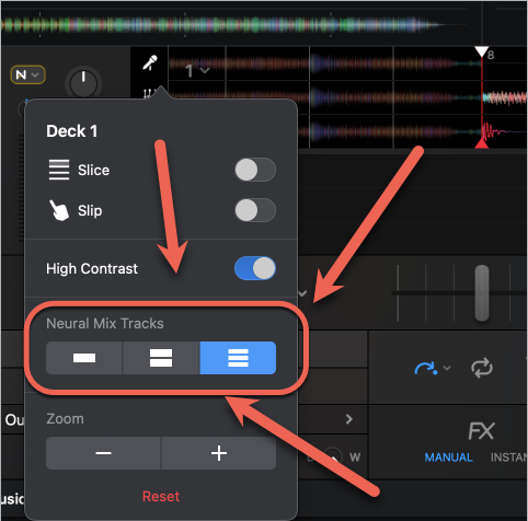

For those who do not know.. we are talking about this setting:

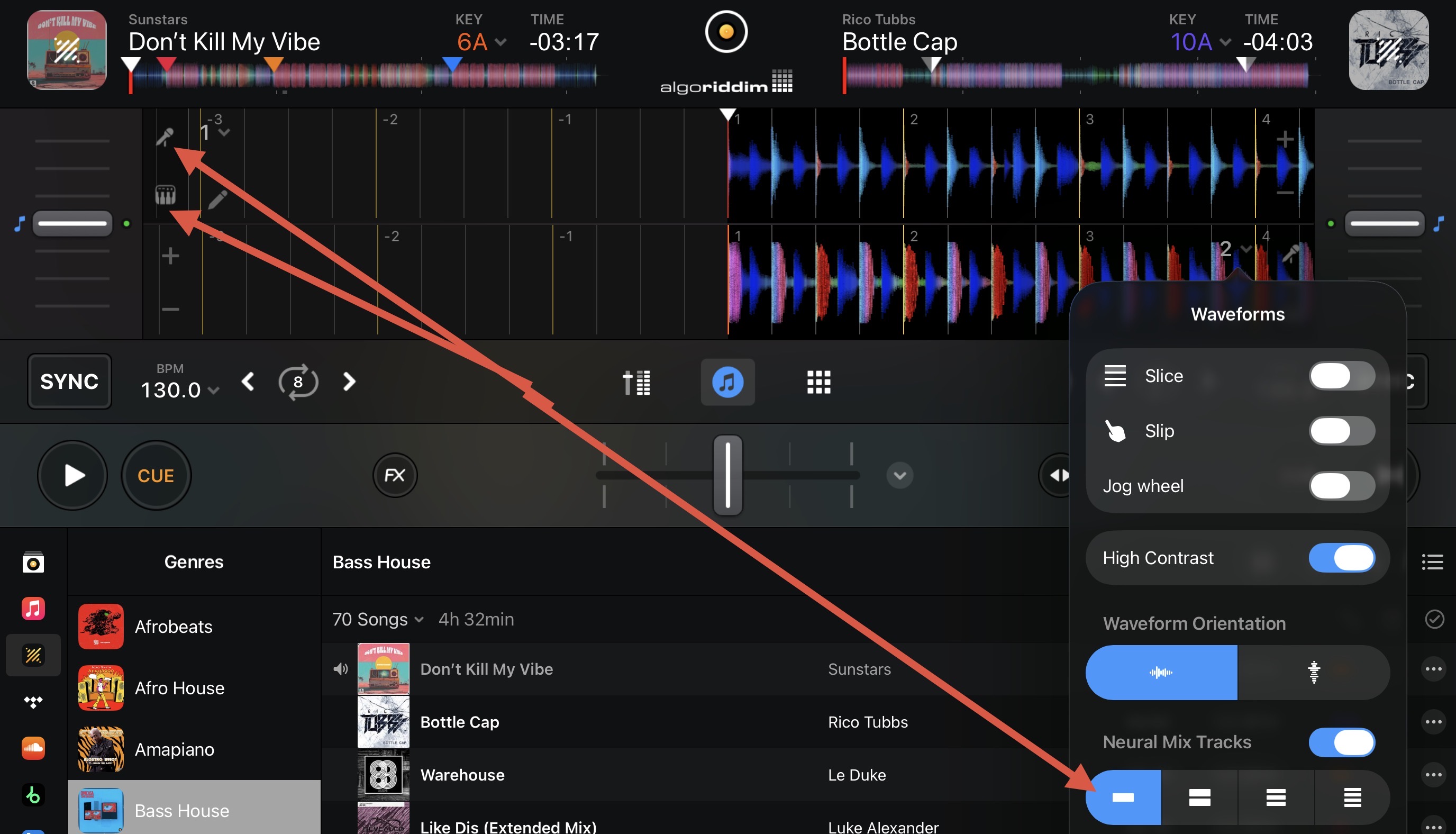

In practice, what does the 1-stem waveform option do??
I have found it to do nothing other than revert the 2-3or4 view back to normal.
I made a suggestion that it should be turned to be the on/off trigger button to force djay to “analyse stems on song load” but o think i didn’t explain it well.
Right now, the 2, 3 or 4 view option actually causes analysis to happen, whereas the 1- view option doesn’t.
To me it’s a redundant button.
Hi @Armigo, the 1 NM Waveform option allows you to see the Instrumental and Acapella NM buttons next to the waveform, while only showing a single waveform to simplify the UI.
Yes it does, but would be nice if it pre-analyzed NM too, like the rest.
