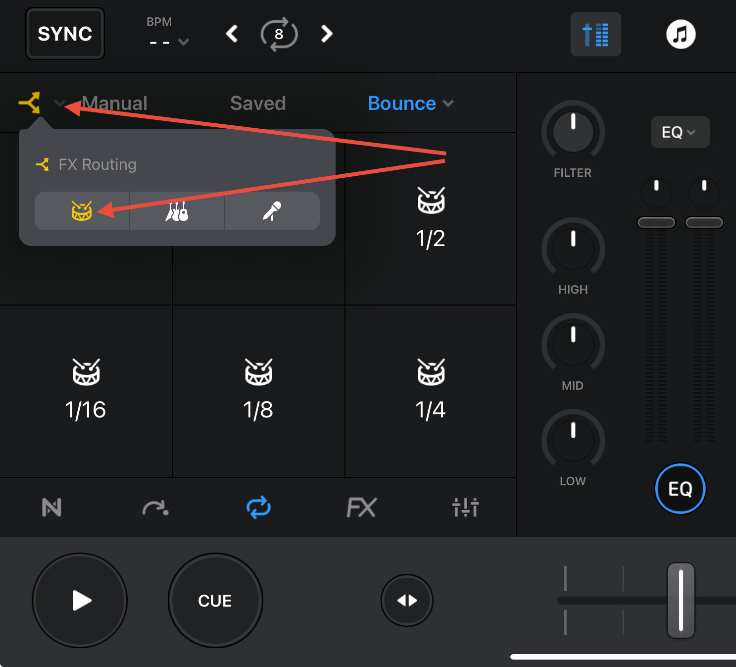

I’m using Mixon 8 pro with Ipad, Djay Software. I want to do the snare roll or drum roll effect, that one use it in the build up
Hi @Ramon_Rodriguez_Clar, welcome to the Community! You could do this in a few different ways, but probably the Bounce Loops would work the best. I’ve shared a screenshot from iOS, it it should be pretty similar on macOS.
You might also want to experiment with some of the manual FX like Handsup, Jet Stream and Looper.

Hi again @Ramon_Rodriguez_Clar, it really sounds to me like either of the suggestions I shared above will achieve the result you are looking for. I would test them out for yourself and practice to get the timing right. Yes, the music will keep playing underneath when using Bounce Loops. Again, just try is out for yourself to see.

You can apply the Bounce Loops to specific STEMs so the rest of the song continues playing underneath.
