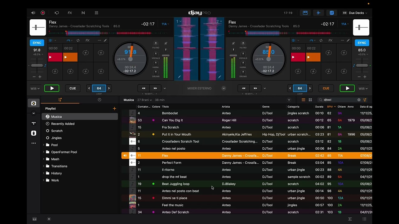

Thank you so much @Slak_Jaw I still have to revert the firmware and the mapping and do the test you asked, but this time I was able to capture an issue, still topic related, which happened to me multiple times, also with previous versions of DJay Pro and Elite firmware.
I also mentioned it in a previous post of this very same thread.
Anyway, as you can see from the video, DJay is showing two playing tempos with relevant difference but somehow they still play synced.

Hi @Slak_Jaw , yes, you can see it happening as well in the other video I posted in the former thread which was done with v 1.06.
I’m starting to realize that most of the time when this happens it’s after having made some transitions between songs using loops and scratching (but that didn’t happen in the other video I just mentioned).
I’m not able to replicate it deterministically but I’d consider this additional info to narrow the analysis

0:41 you can see that happening here as well
