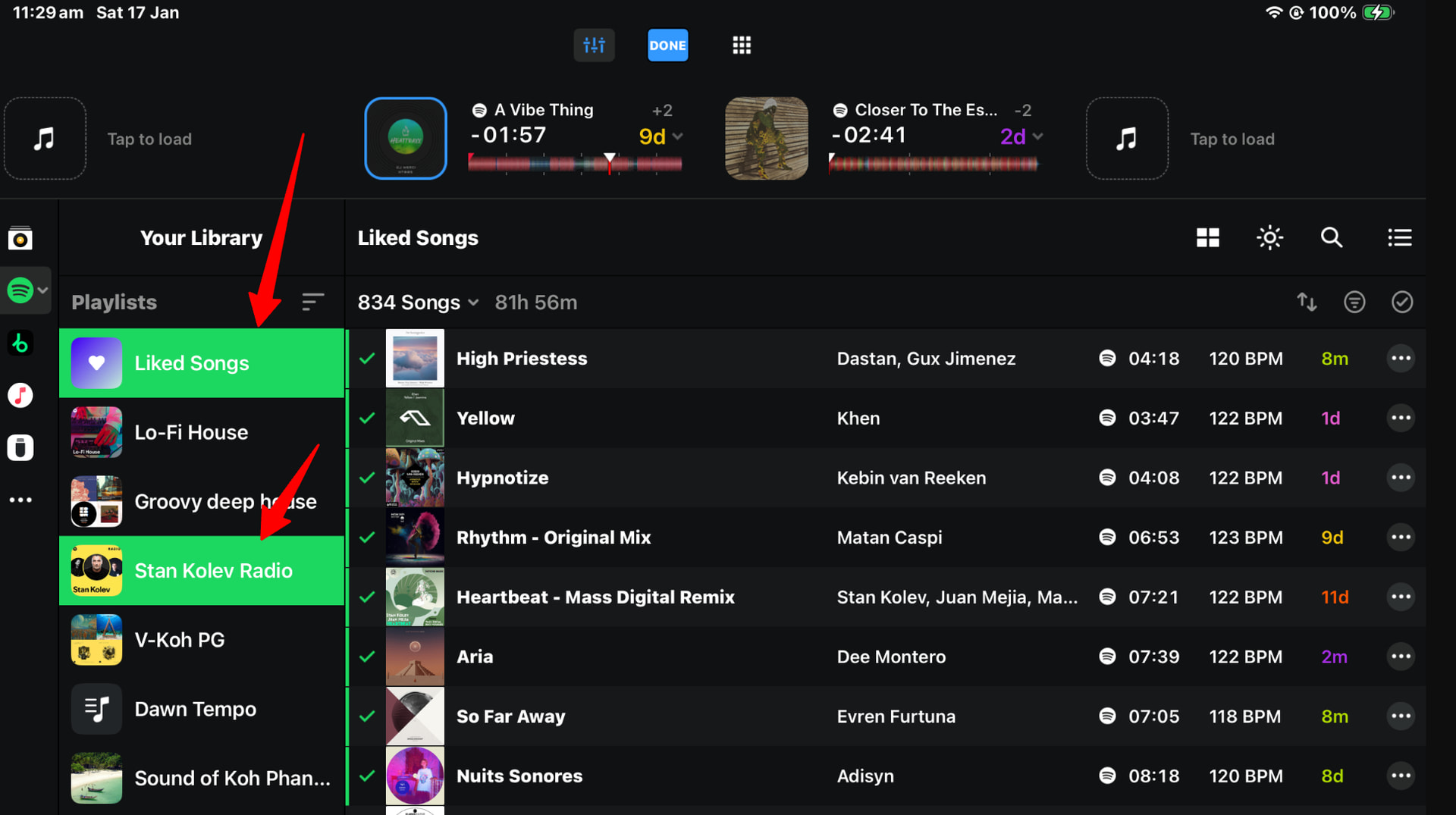

Spotify Library always reverts to Liked songs
I’m using the latest version of DJAY 5.6.1 on my M4 iPad on iOS 26.2 with a Mixtour Pro and a Xone K3
  • Every time I use the browse encoder the selected playlist reverts to the Liked songs playlist which is the first playlist for me. Additionally two playlists are highlighted
  1. Select any song from and playlist and load
  2. Close browser
  3. Open browser
C) EXPECTED RESULTS:
  • Previously selected playlist should be selected
D) ACTUAL RESULTS:
  • Liked songs or first playlist is selected

Regarding the first issue, I was able to reproduce this on my iPad and have passed this onto our engineering team for further review.

Hi @rishi and @BillPayer, engineering has identified the issue and is working on a fix which should be included in an upcoming update (likely 5.6.2). Thanks!
