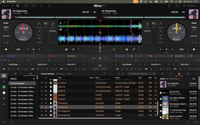

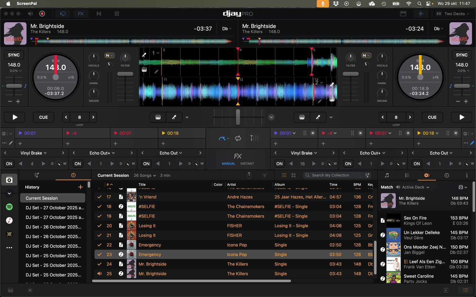

When using Spotify tracks in djay that are also available locally, several issues occur that affect cue points, history, and track source integrity.
Steps to reproduce:
  1. Load a Spotify track that also exists as a local track (track length should be ± the same)
  2. You can see it takes over the Cue Points from the local track
  3. Play the track and observe the history and cue behavior.
  4. Load the same track again.
Observed behavior:
  1. Cue points inherit from the local track are often misaligned.
  2. After playback, Spotify tracks in the history list are replaced by the local versions.
  3. The icon in the history list shows the wrong source (local or iTunes icon instead of Spotify).
  4. Reloading the track originally from Spotify shows local album art and corrects cue points according to the local track, effectively replacing the Spotify track completely.
What I was expecting:
  • Spotify tracks should maintain their own cue points and loops, independent of local versions.
  • History should retain the original Spotify track and source icon.
  • Loading a Spotify track should not replace it with a local version automatically.
Additional:
  • Ideally, Spotify tracks should not inherit cue points or loops from local tracks at all, even if the track exists locally.
  • This is causing unreliable performance and inconsistency when mixing Spotify tracks.
See video:
Device: MacBook Pro (16", 2019)
Processor: 2,6 GHz 6-Core Intel Core i7
Operating system: Mac OS / Sequoia 15.6.1 (24G90)
Djay version: Djay Pro 5.5.
Hardware/controllers used: Reloop Mixon Pro 8
Is this expected behaviour @Slak_Jaw ?
