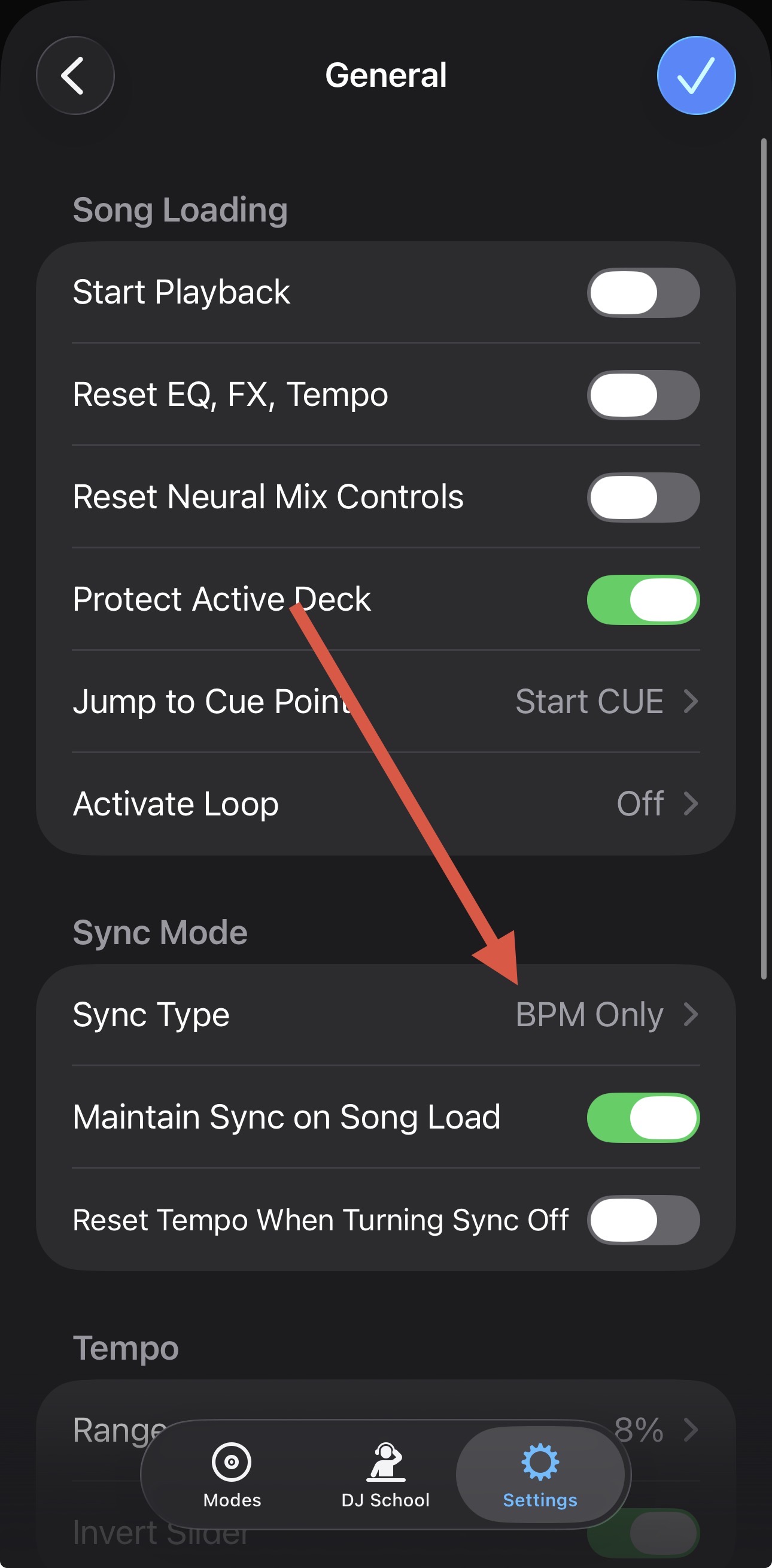

Hi @MisterNuevo, in the djay Settings>General>Sync Mode you can set it to BPM Only.
In sync type ‘BPM and Beats‘ you can achieve this by checking off the ‘resume sync after pause, scratch or cue jump‘.
This way you have exactly what you describe. You have beat sync, but when you pull the track out of phase, it doesn’t snap back, though it keeps the tempo it’s playing.
Thanks @Kikeon!
