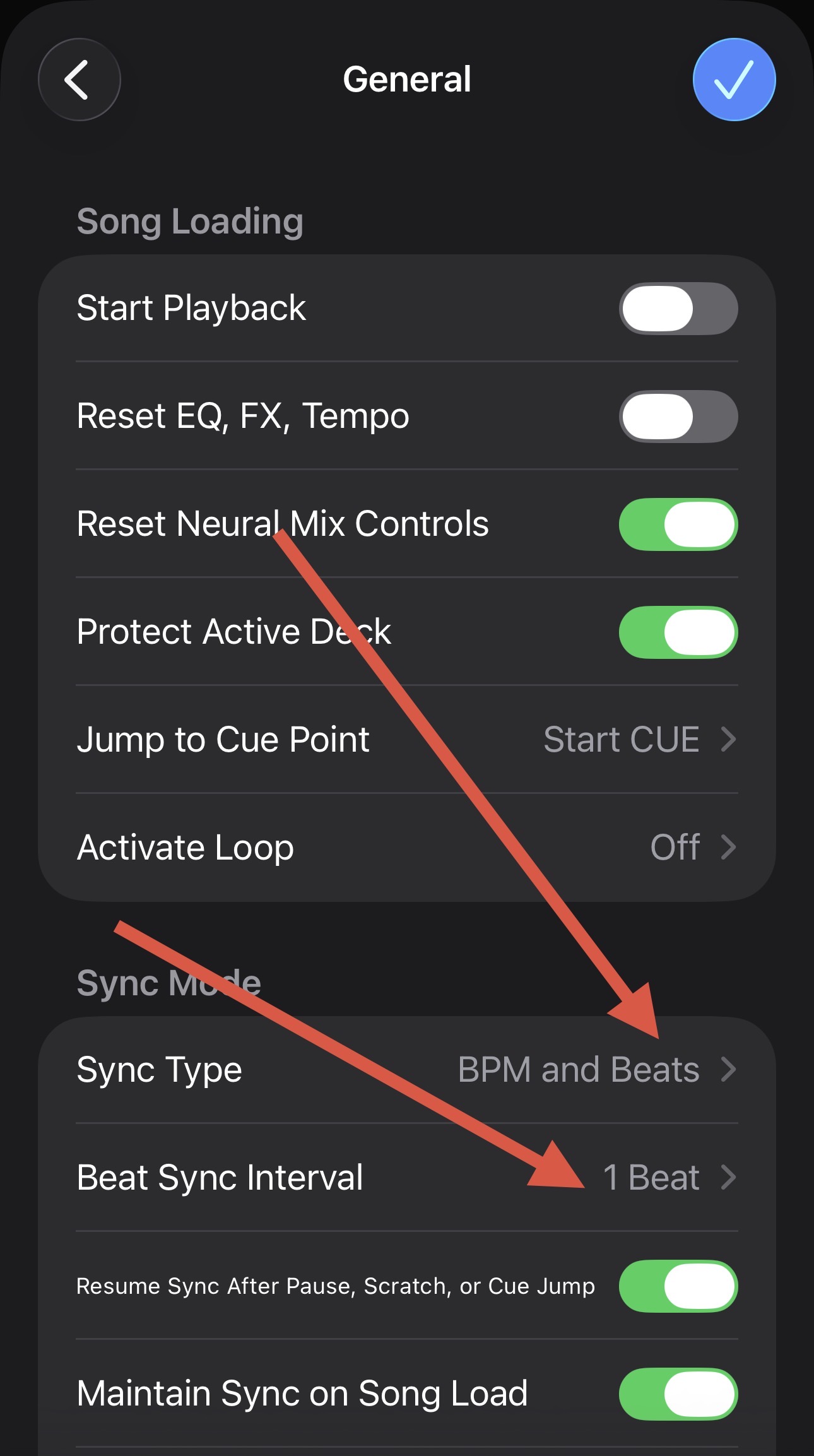

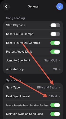

Hi @Stick, welcome to the Community! Please navigate to the djay Settings>General>Sync Mode>Sync Type and set it to “BPM and Beats”.
@Slak_Jaw I’ll try that thank you!
Thanks @Slak_Jaw think thank you so much, I think I’m nearly there as that has fixed the beat sync issue and mainly the loop issue.
However if the track I’m playing I want to loop when I hit the button that jumps. But the one I’m quing doesn’t? It only jumps on the main master deck being played.
Thanks again for your help.
