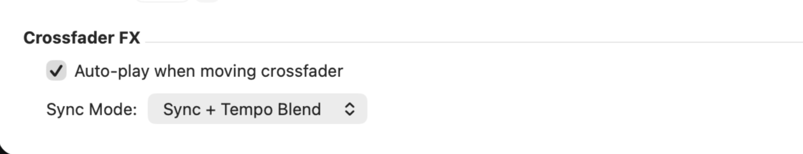

My mistake @IncredEvents, sorry about that! I shared this with our engineering team and this is in fact a bug. They are already investigating this further and working on a fix which should be included in an upcoming update (likely 5.5.2). Thanks!
In the meantime, you can still enable this in the djay Settings>General at the bottom.
Hello @IncredEvents, djay 5.5.2 was released earlier today and should address this issue. Thanks!
