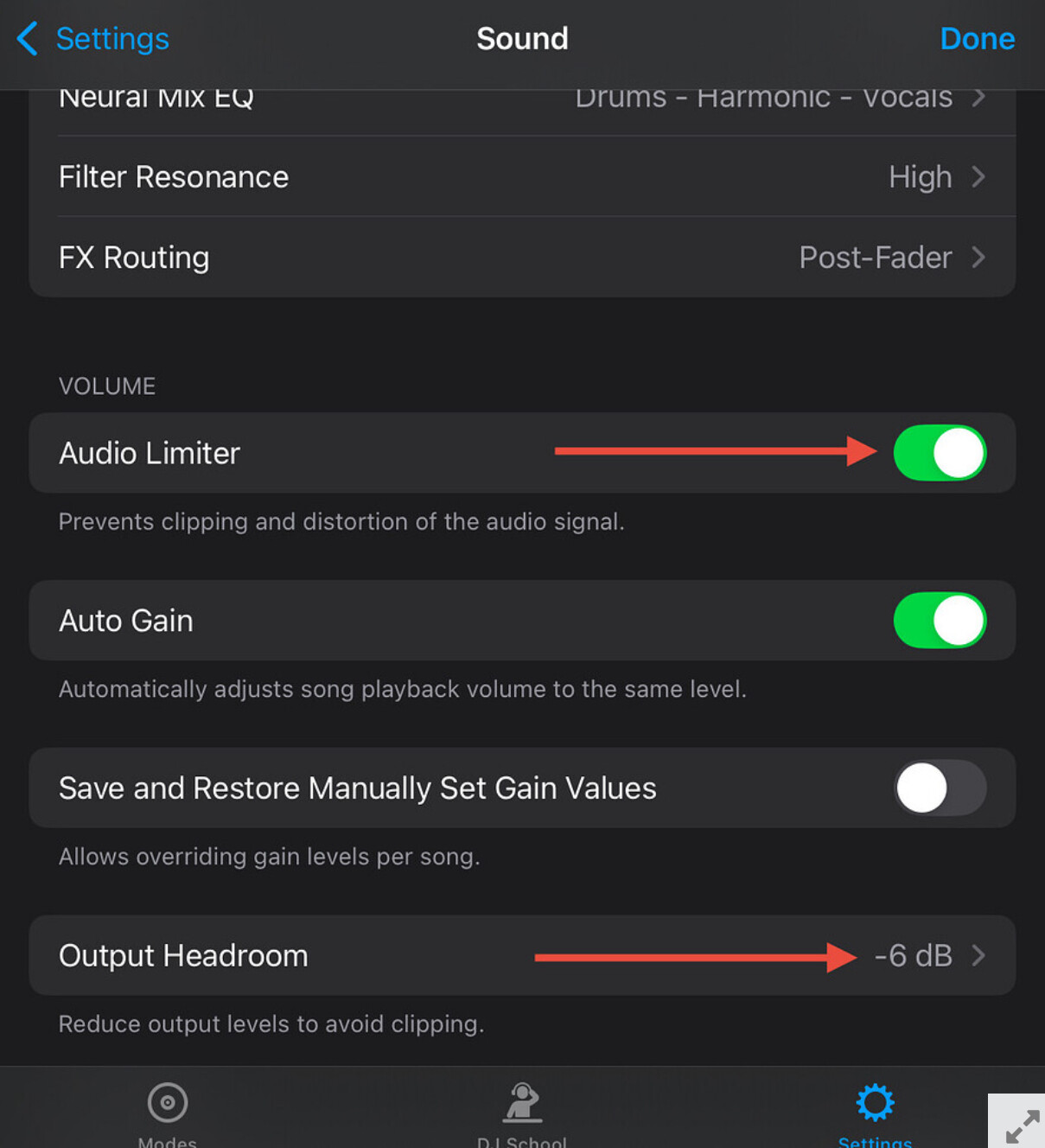

In the djay Settings>Sound you should consider turning On the Audio Limiter to prevent clipping and distortion of the audio signal. You should also consider adjusting the Output Headroom. I hope that helps!

Hi @boing, the channel fader at maximum is normal and expected. There is no setting to change this. I recommend that you enable the Audio Limiter and increase the Output Headroom to -9, -12 or -24.
