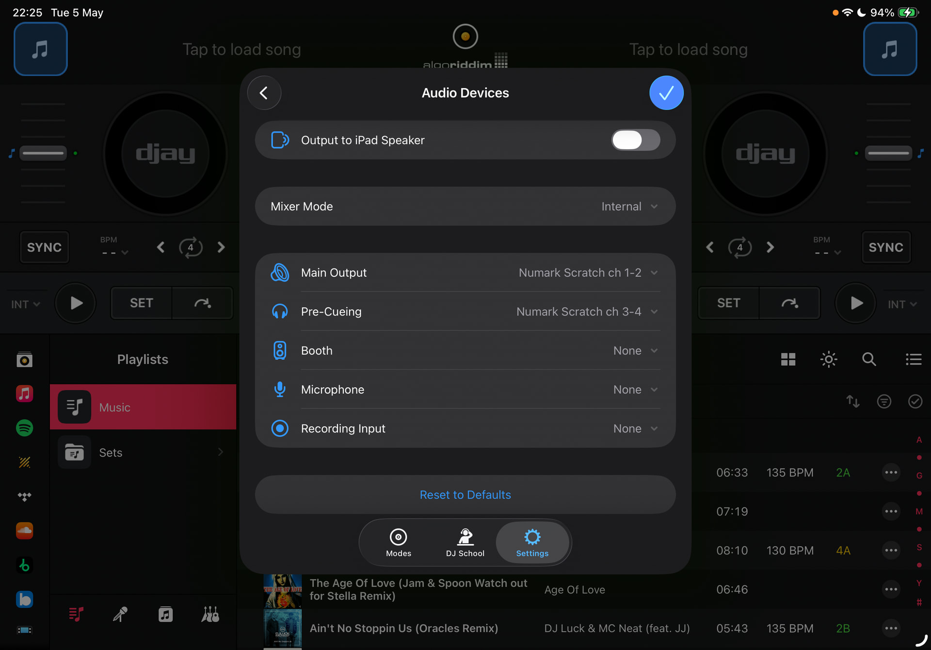

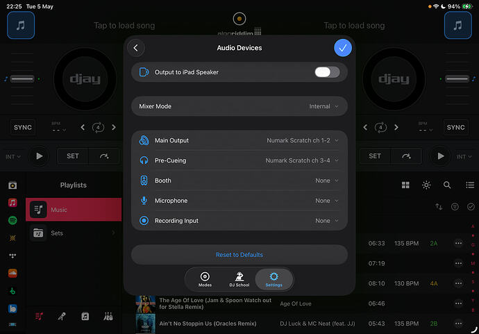

  1. Please share screenshots of your djay Settings>Audio Devices

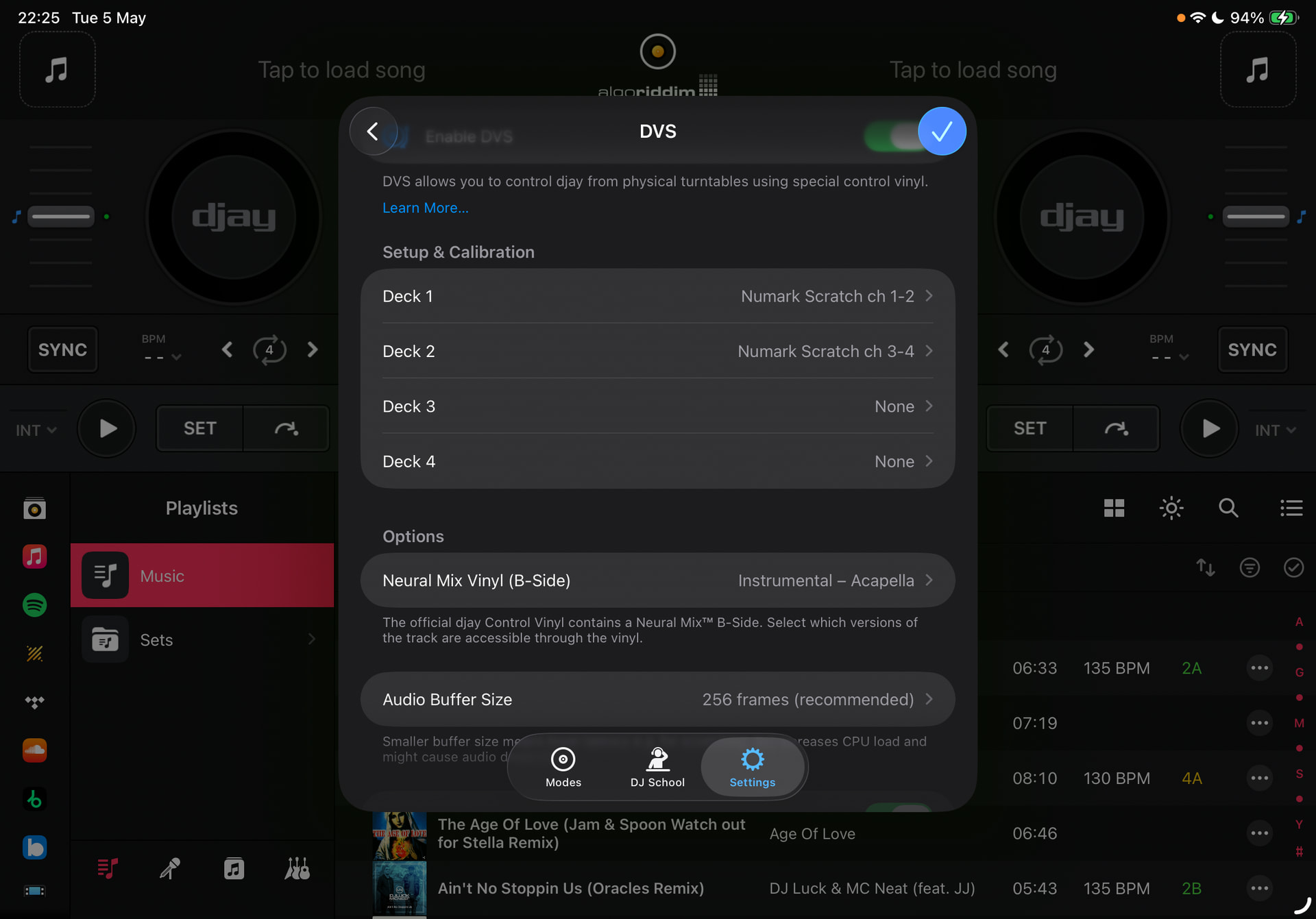

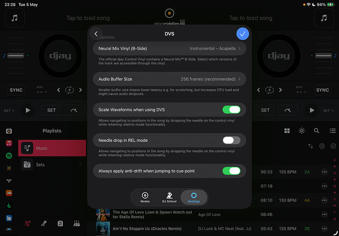

  2. Also, your djay Settings>DVS

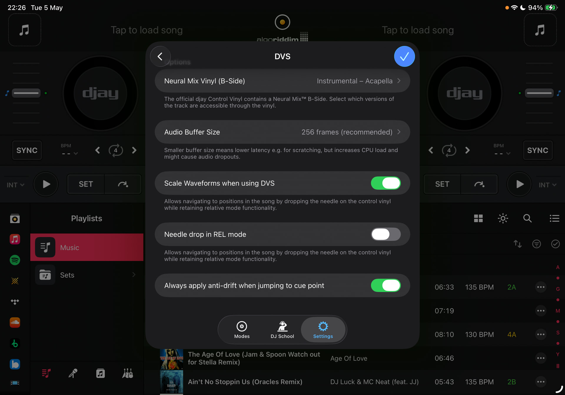

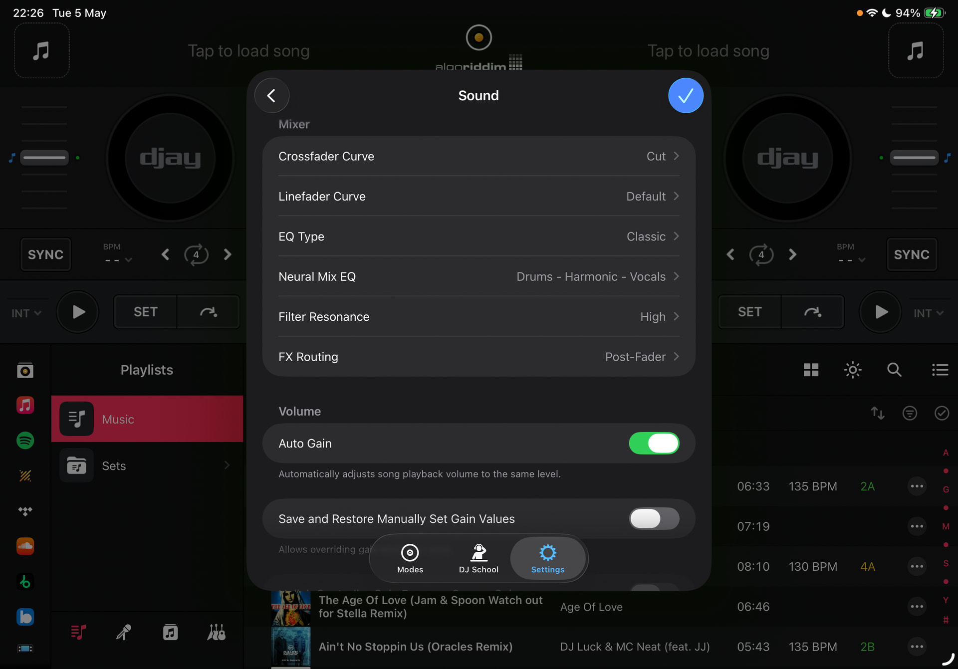

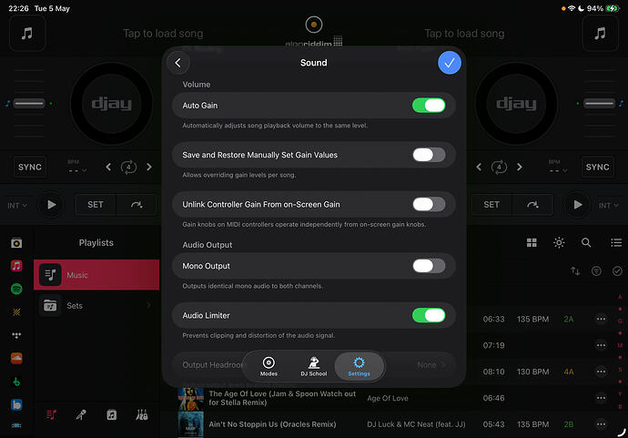

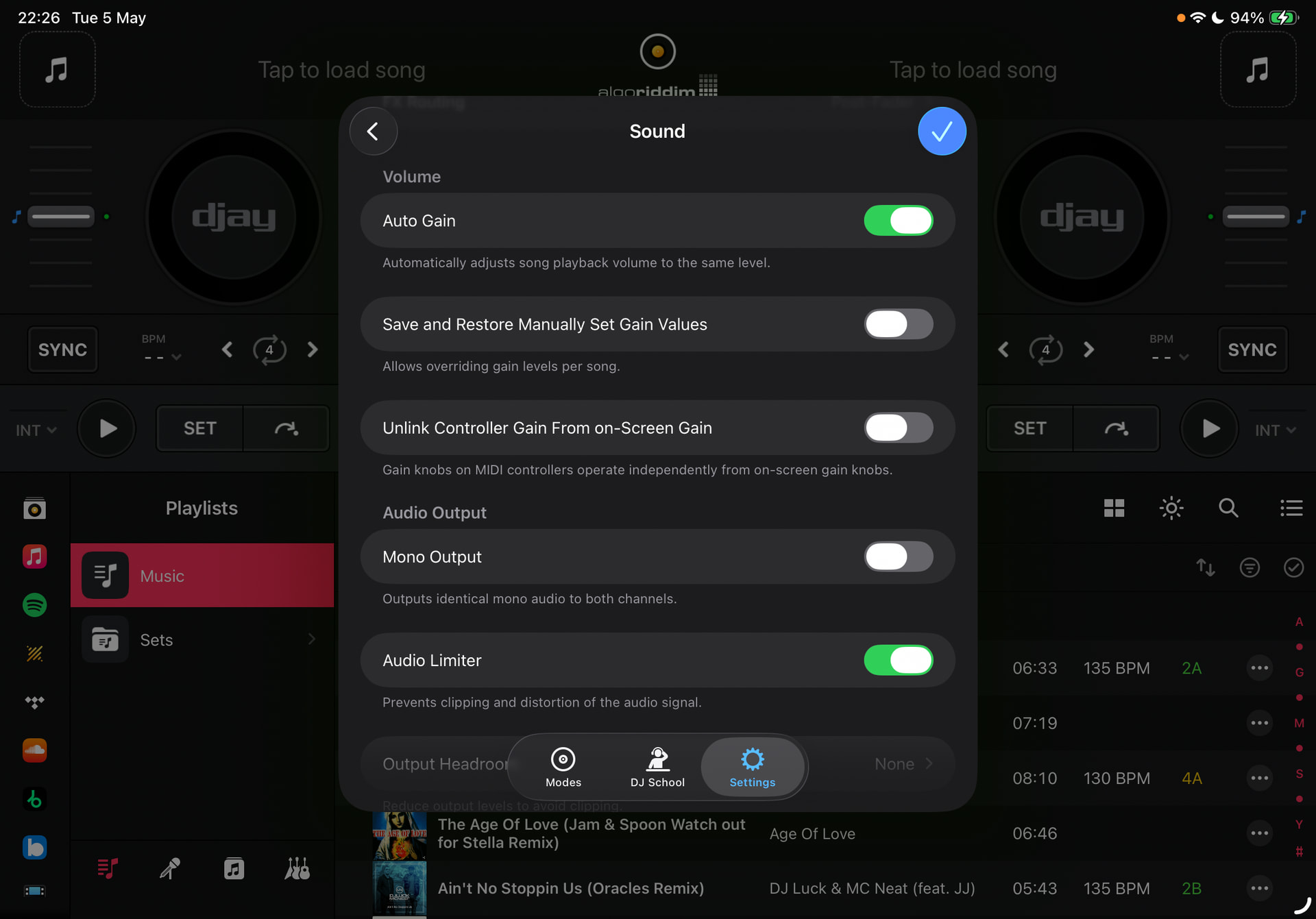

  3. Also, your djay Settings>Sound

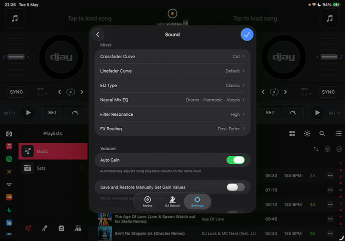

Hey. Screenshots attached… Looks like I added them back to front! I did try turning off auto gain, but thankfully didn’t resolve.

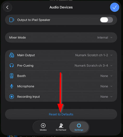

  1. Please try Reset to Defaults in the Audio Devices section

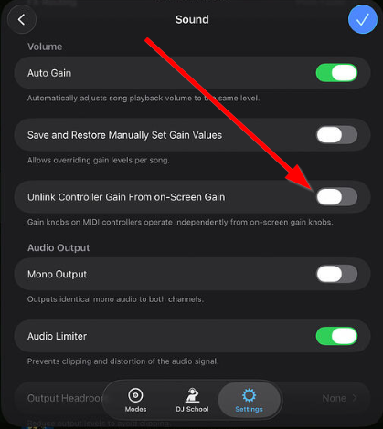

  2. If that doesn’t help, please try enabling Unlink Controller Gain From on-Screen Gain in the Sound Settings

The reset defaults didn’t do anything. But the disconnect of the gain controller from the on screen worked, thank you!
What does that control actually do? As it seems to lower the volume a lot on the digital tracks when it’s enabled. Does it mean you lose the benefits of auto gain etc?

This setting basically allows you to tweak the Autogain set by djay, via your hardware without resulting a big jump in volume. With this setting off, when you turn the gain knob on your hardware, djay with jump to the knob position of the hardware. So, if for example, Autogain has turned the gain way to the left of center, and you turn your hardware gain knob from the center position, the gain will immediate jump to the center position.
I’m not 100% sure, and I don’t have access to this hardware to confirm. I’ll pass this onto our hardware team to confirm though.
Hi again @andybarnes, sorry for the delayed reply. I discussed this with our engineers. It is expected behavior that you have to use “Unlink Controller Gain from On-Screen Gain” to be able to gain THRU signals. The on-screen gain knob is deliberately disabled for THRU mode because that could contain autogain of whatever track is cued up on the virtual deck. I hope that helps!
