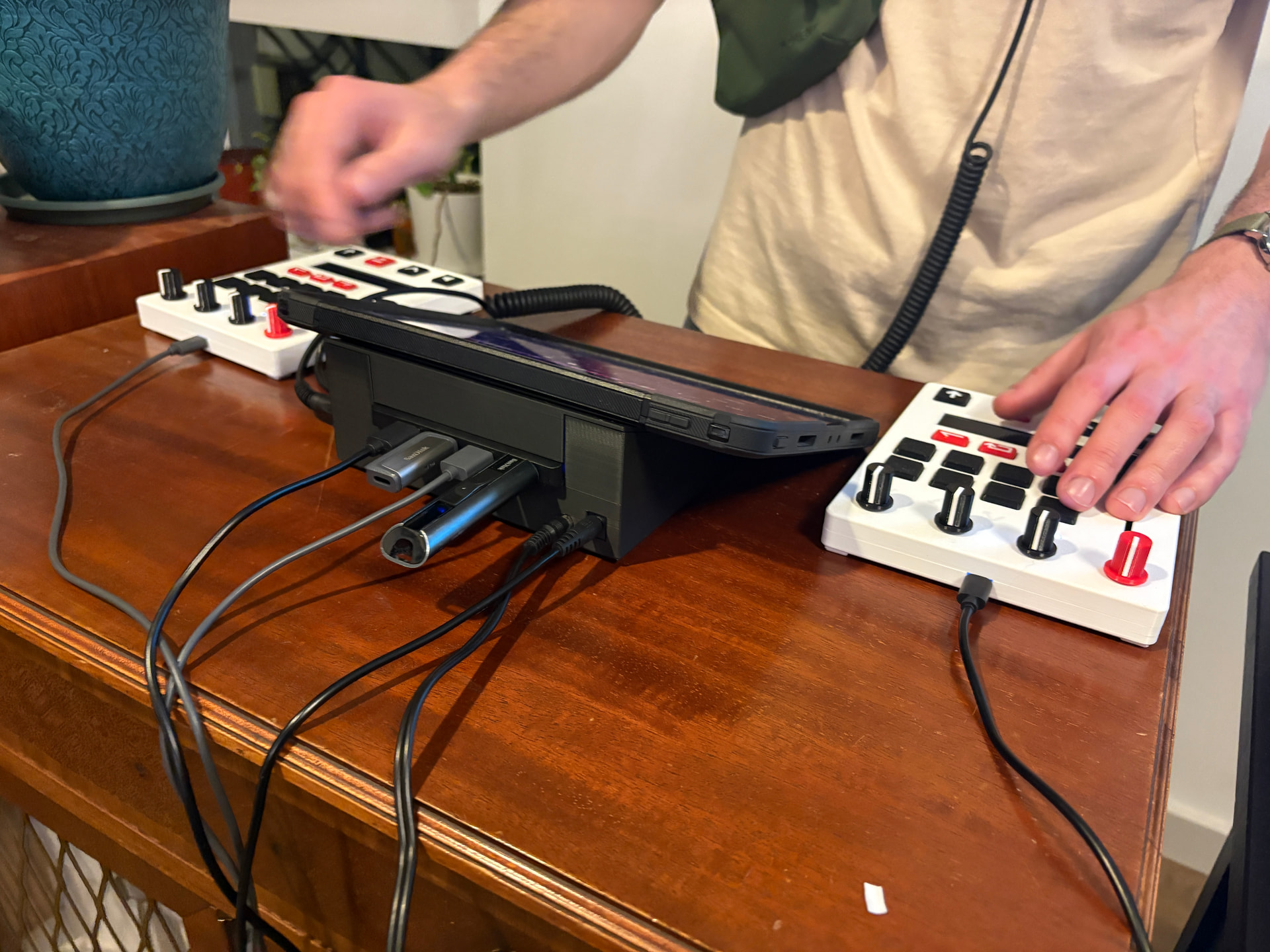

I cobbled both DACs together and fed one into an amplifier circuit to get it to the right audio level for a mixer and then designed a 3D printed enclosure for everything.
After I get the Takeout Box launched, I have plans to fabricate a cheap multichannel USB interface w/ an integrated USB hub.
