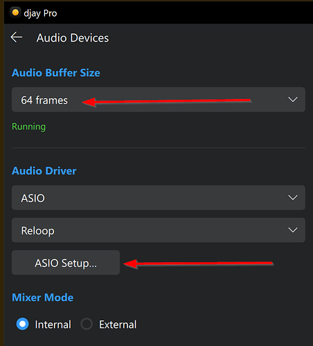

Hi @evelyngrace, disabling Keylock on both decks should make an improvement in latency. You can also experiment with adjusting your audio driver buffer size in the djay settings. A lower buffer size will reduce latency, but increase CPU load and at a certain point will increase audio glitches. Your Audio Driver may have some additional settings that you can adjust to minimize latency.
Thanks for good suggestions. Finding the right buffer size is important because going too low can cause audio glitches.
