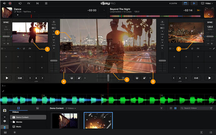

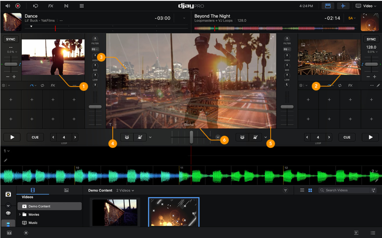

Hi @POSM, sorry to hear you’re experiencing this issue. I just tested Video Mode on my M1 MBPro with macOS 26.6.2 and djay 5.6.8 and everything seems to be working as expected. The first thing to rule out is the file itself. On Mac, djay’s video decks support H.264 and MPEG-4 at up to 1080p / 30fps, in .mov, .m4v or .mp4 — a file outside that (HEVC/H.265, VP9, .mkv, .avi, or 4K/60fps) will often load and play the audio fine with no picture at all. That catches most “it worked before, now it doesn’t” cases where a batch of files got re-downloaded or re-encoded somewhere along the way.
If your files are already inside that spec, then the next thing I’d check is whether you’re actually in Video mode and seeing the deck previews, or whether the audio is playing with the video window blank. Those are two different problems and they get fixed in two different places.
