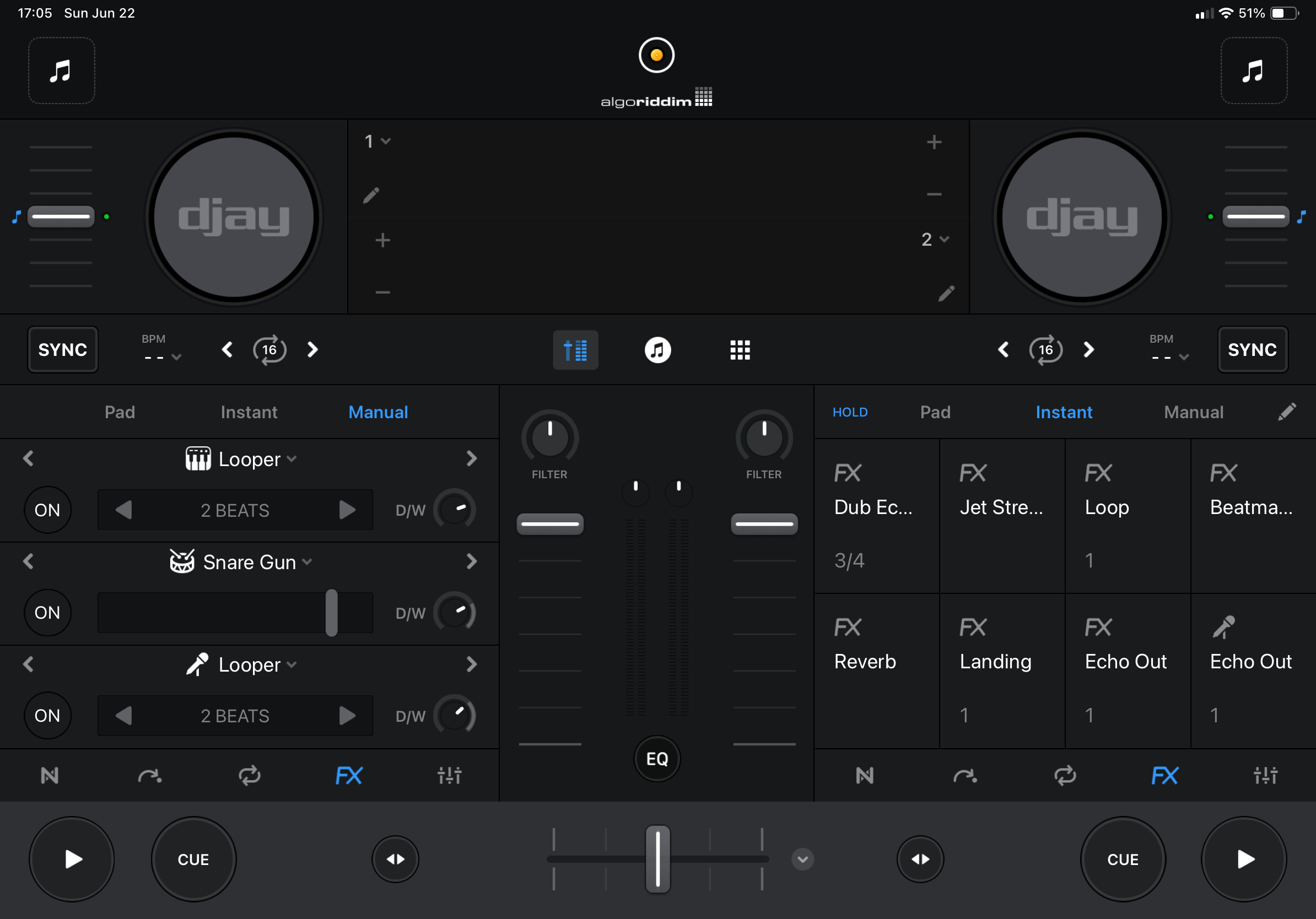

Hi, just a general question to the community with regards to effecrs and what people like to use
I’ve recently got back into DJ’ing and exclusively use Djay Pro with a Reloop Mixon 8, put toghether a few mixes of my own now and happy with where I’m at and constantly learning on the job and experimenting, which gets me onto effects
I tend to mix more Disco, 70’s-90’s tunes with a bit of vocal house. I currently have my three dedicated effects set up to Vocal Looper, Snare Gun on Drums and Looper on Hamornies, my 8 dedicated effects are Dub Echo (which I like a lot for transissions) Jet Stream, Loop, Beatmasher, Reverb, Landing, Echo Out and Echo Out (Vocal Only) - see screen grab below
