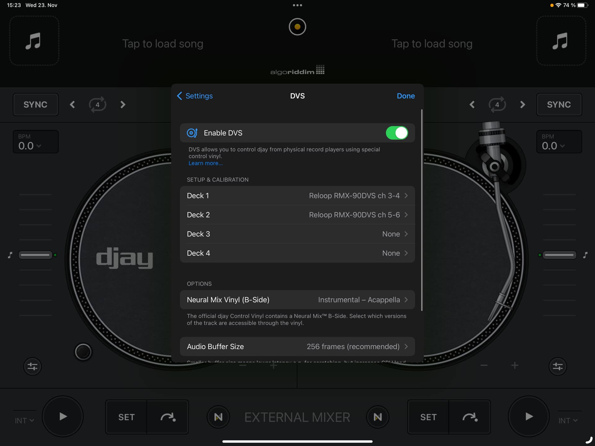

Which audio interface are you using? I ask cause I am using the serato vinyl now without issue.
I have 2 Reloop RP8000 and a Reloop RMX90 DVS.
I go with all 3 devices via USB to a USB hub and then via USB C into the iPad.
The mixer is recognized immediately, but I cannot visualize a DVS signal from vinyl.
Under Serato DJ it worked like this. But I switched from WIN 10 laptop to a IPad.
Drop a screenshot of your input settings in DJay
The turntables are connected to the mixer via chinch.
The turntable line switch I have also already checked.
When I play the control vinyl nothing happens in the space input source, normally there should be a circle, I have already tried the channel input switch on the mixer all without success.
Unfortunately, the RP8000 are not supported and recognized via USB, Reloop has no new FW that supports IpadOS,
Try switching the inputs in djay to another pair then back again and see if you get time code signal.
You mean to ch 1-2 or 7-8 I have already tried that, suffering also without success
I am surprised that I do not get any signal, not even a bad one.
Likewise. Just a heads up, even with the needle not on the record, I get a little dot in the time code window. This may be something other than a time code issue.
I have found the error. Each channel has 2 inputs, I have to use the CD input on Phone it does not work.
Thanks for your support.
