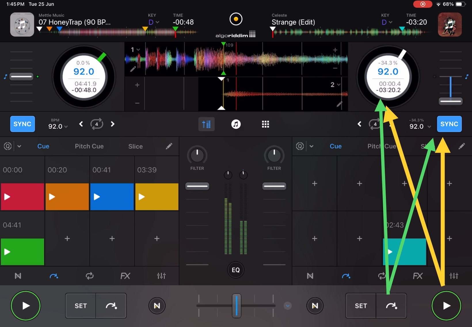

iPad. Pro mode.
Deck 1 is playing. Sync off.
Manually cue in deck 2. Press cue jump and/or play and sync triggers changing bpm.

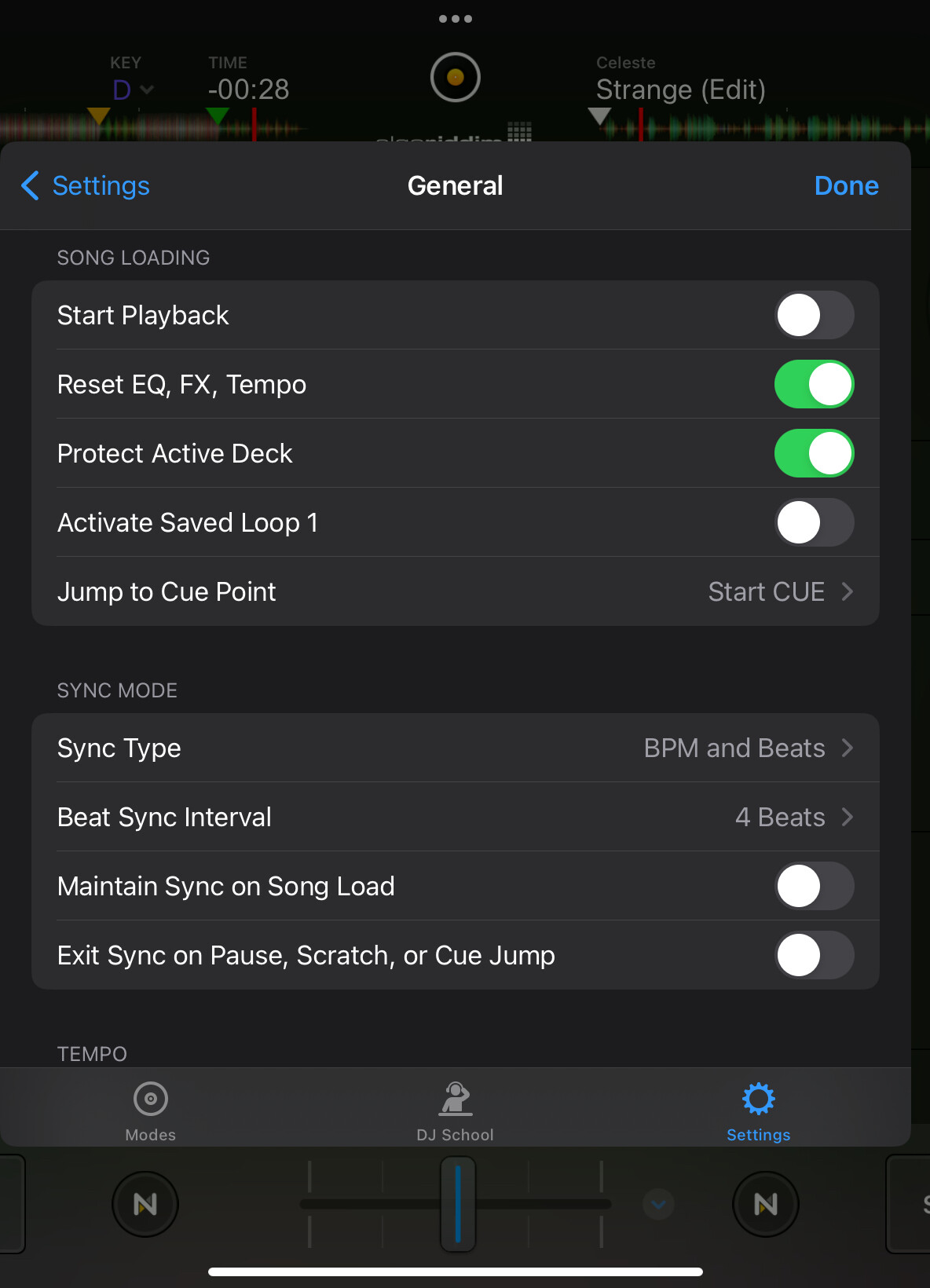

Checked settings, looks ok, but settings can be a bit - huh?

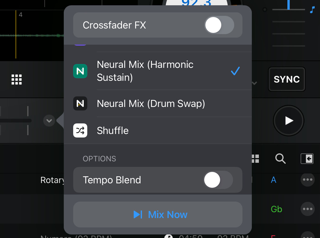

Ok, thank you, I would never have figured that out. I’ve tried to find Crossfader FX on help pages without any luck, I assume it’s the same as Crossfader Fusion? Maybe call it Crossfader Confusion? ![]()
While I see the benefits of the features, also look pretty dangerous - as in WTF is happening? moments playing live - because there is a lack of clarity as to what mode you’re in.
There will also be a reason why this FX ‘switched on’ I’m not consciously aware of doing it. So that’s a problem. Makes me nervous.
Upon further investigation, I had a go at using Crossfader FX but without Tempo blend switched on, but it was still doing the tempo blend thing. Is this a bug? Is there a way to lock the BPM, so I can use FX without tempo blend?
Another thing I’ve noticed is when Crossfader FX is switched off you can still select an option, so its not clear whether it needs to be switched on or not for crossfader modes to work.

Hi @N_C, you’re welcome! Happy to help. Please navigate to the djay Settings>General, scroll down to the bottom and make sure Auto-Play When Moving Crossfader is OFF and you can also set the Sync Mode to OFF.
You can easily tell when CFX is enabled when the vertical line of the Crossfader is Blue instead of White.
CFX needs to be ON for it to do anything even if you have one of the FX selected.
