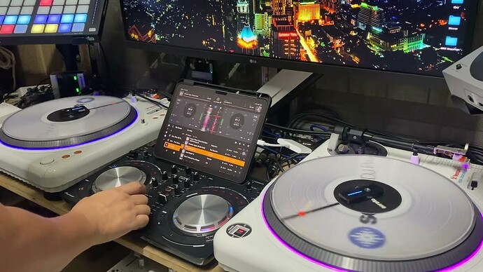

@djfoxen @Kikeon Hello
Have you been able to test a Traktor Audio 6 iPad setup with DJAy Pro in DVS mode? Does it work? Thanks.
Hi @Florian_Ducellier, welcome to the Community!
Djay Pro
Pioneer DDJ Wego3
NI Traktor Audio6
Vestax PDX-2000
Phase DJ
Excellent! Thanks for sharing @basskaa
Yes! Traktor Audio 6 works with DJAY Pro in DVS mode on an iPad. This is my setup. I actually use Phase as well. So I have the Phase audio outputs into the Traktor Audio 6, through an usb hub to DJAY pro on the iPad and then the Traktor Audio 6 output signal into the line inputs on my mixer. Works like a charm!
