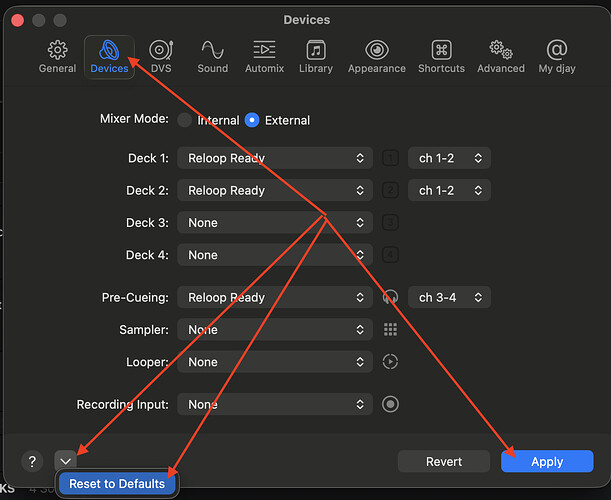

Thanks for the info @Beppe85. Please try the following:
  1. Connect the XDJ-AZ directly to your Macbook via a high-quality, properly shielded, USB cable with dual ferrites. Do not use any USB Hubs or USB adapters.
  2. Please then go to the AlphaTheta official support website and download and install the latest Ver. 1.24 XDJ-AZ Firmware: https://alphatheta.com/en/product/all-in-one-dj-system/xdj-az/black/#support
  3. After updating the firmware and rebooting your device, please launch djay again.
  4. Once, connected, please navigate to the djay Settings>Devices, expand the drop-down at the bottom and select Reset to Defaults. This will restore the correct audio settings - note that this hardware must be used in External Mixer Mode only.
  5. Now retest and confirm if any issues persist. If issues do persist, please capture and share a short video to clarify the problems and I can try to assist you further. Thanks!

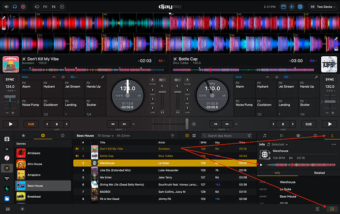

EDIT: It sounds to me like you are trying to use the Track Preview (see below). If so, this is indeed a limitation with the XDJ-AZ as it is an External Mixer Mode device and is missing the necessary hardware feature for djay to route the track preview directly to the headphones. This is common with most external mixer mode devices used with djay. However, normal cueing in the headphones with a song loaded on a deck should work as expected with the XDJ-AZ.
