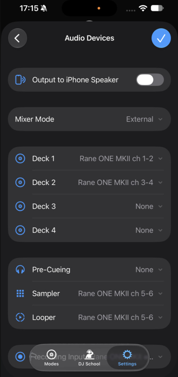

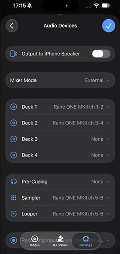

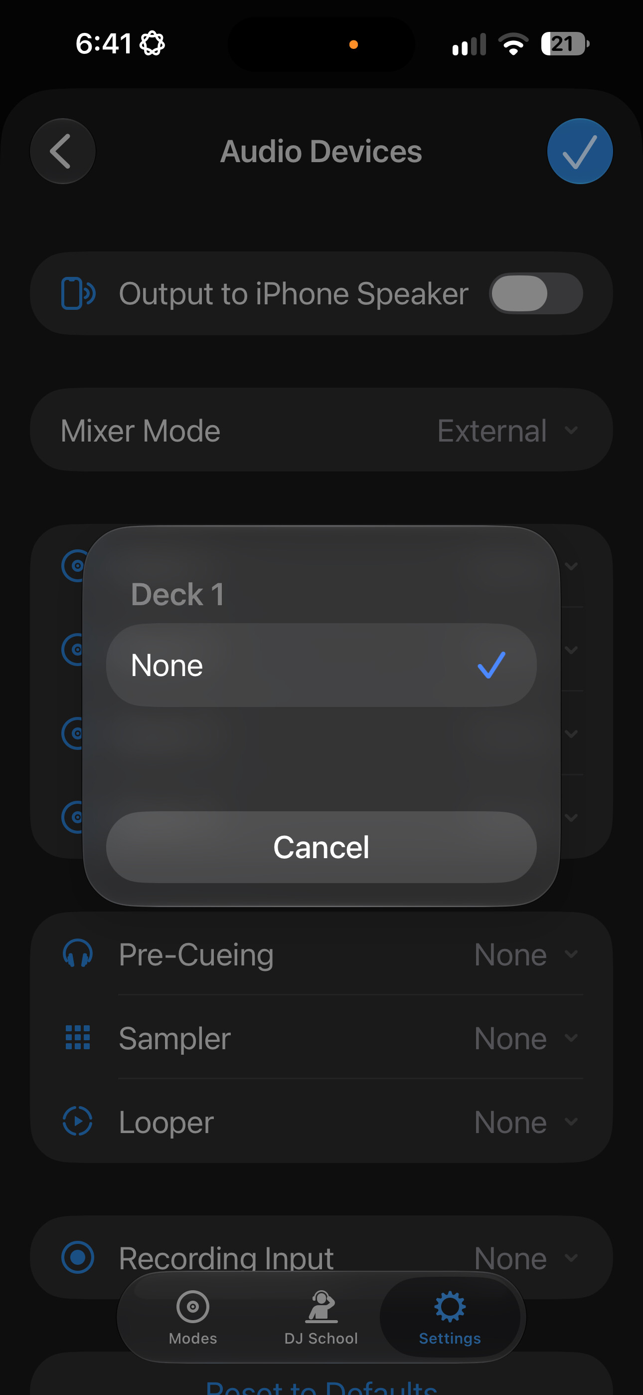

I wasn’t thinking and updated my iPad and phone to the newest iOS and iPadOS 27 bad habit but nbd these are just backups for djay. Djay is able to be controlled by the platters and crossfaders BUT, it’s not recognizing the one mkII as an external device and sound is only coming out the iPhone and iPad. I’m assuming they’re just not compatible atm? Just a heads up lol
Thanks for sharing @jmoak311. I’ve merged your topic with this existing one.
Hi again @jmoak311, our engineering team just tried to reproduce this with a similar setup on iPadOS 27 and everything is working as expected.

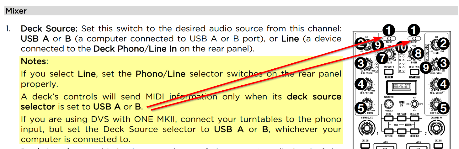

  1. Can you please confirm that you have the Deck 1 and Deck 2 Source toggles set to the USB port you are connected to?
  2. If that doesn’t work, can you please try switching to the other USB port and Source toggles?
  3. If that doesn’t work either please try a different USB cable.

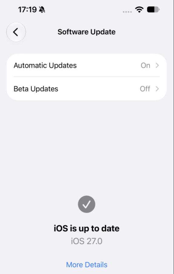

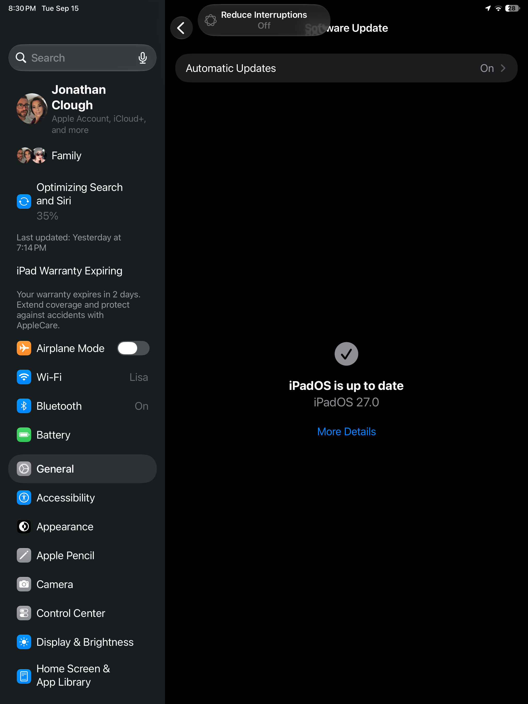

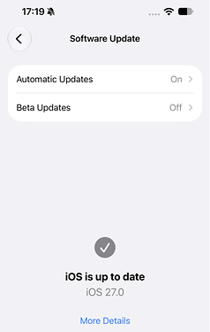

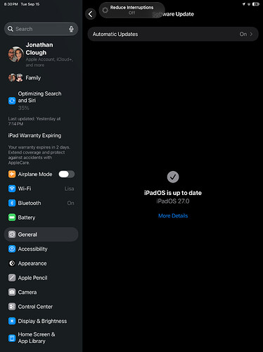

  4. Can you confirm that you are running the official iOS 27.0 release and not a beta version of 27?
Definitely the right iPadOS. I was able to get it working right before bed, although it was inconsistent, and I wasn’t sure exactly what I did differently when it did connect. I swapped out USB cables, toggled back-and-forth between source A and B, and at different times I got both of them to connect with the original USB c Chroma cables. When I have more time I’ll figure it lol.
oddly enough, at my event Saturday, my left platter wasn’t responding (Rane one mkII with MacBook Pro M2 Max, no software update). I swapped usb c chroma cables, toggled back and forth from source a to b with the opposite cable. Restarted the Rane one mkII and mbp. Nothing happened. Then after going back to the original cable it connected and worked fine all night. All of my cables are USB c chroma cables, maybe two years old. Idk maybe it’s just time for new cables. At first glance the issues might not seem related since one was iPad and the other MacBook, but I have two devices on two different Rane one mkII’s having what appears to be an issue connecting. I’m definitely not blaming dj, but it sounds like it’s a “me” issue lol.
Thanks for the additional info and screenshot @jmoak311. Hmmm… this does sound more like a hardware issue than a software issue. Especially since you’re having similar issues on your Mac running an older OS. Maybe a grounding issue. Are you using a high-quality surge protector/powerbar and have you tried connecting to a different outlet separate from your PA or sound system?
