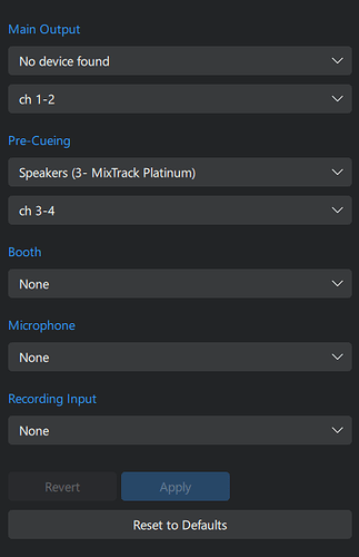

Hi All - Recently started having an audio issue with Djay Pro on Windows 11. - Under the main output on audio devices, I just get “No device found” & am unable to select an audio output.
No issues at all on any of the other outputs - Pre-cueing & Booth both work fine and I can select the correct output devices from the drop down. Just on the main output, I am completely unable to select anything & therefore cant get anything to play out of my main speakers.
I can sort of “Hack” it to work by selecting my preferred audio output on the booth output, but doing this means I have no control over the master gain on my mixer. So not an ideal fix.
I’ve tried a total re-install of the app, ran all Windows updates & updated all audio drivers. Nothing seems to fix it. I’ve been using the software for years with no real issues, but now its pretty much unusable.
Details & screenshot of the issue below - Would appreciate if anyone has any ideas or config changes I could try. I’ve looked on the Forums for something similar but not had much luck.
Cheers.
  • Device model: Surface Pro 8
  • Version of operating system: Windows 11
  • Version of djay: 5.4
  • Hardware/controllers used: Numark Mixtrack Platinum

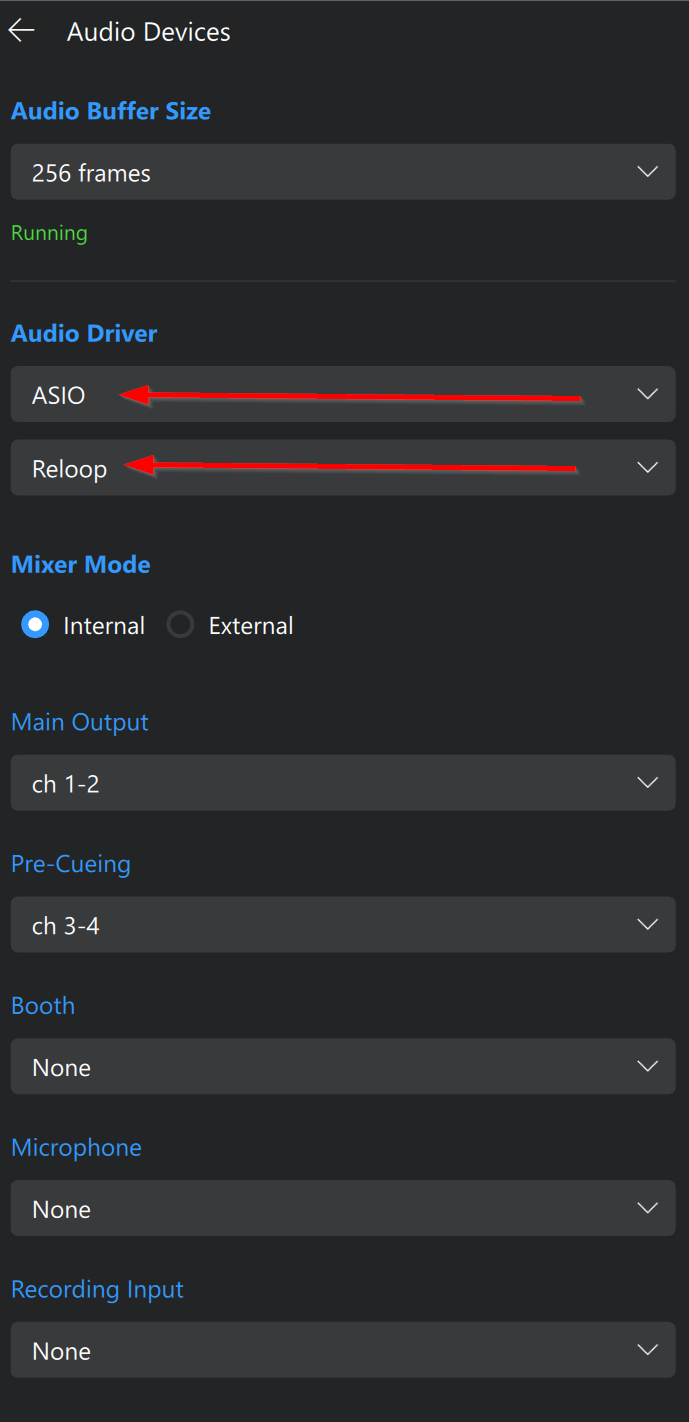

Hi @P4blo and @P4blo, thanks for the additional info. In the Audio Devices settings do you have any Audio Driver options to choose from?
Having the same issue since the update, and I do not see audio driver settings like you show @Slack_Jaw, but i never did. I was just using my toslink out from my motherboard and it had been working since i found the app, until this update.
Hi @Tek, welcome to the Community! Can you please provide full details about your setup?
Hi @Slak_Jaw - No audio driver options appear at all.

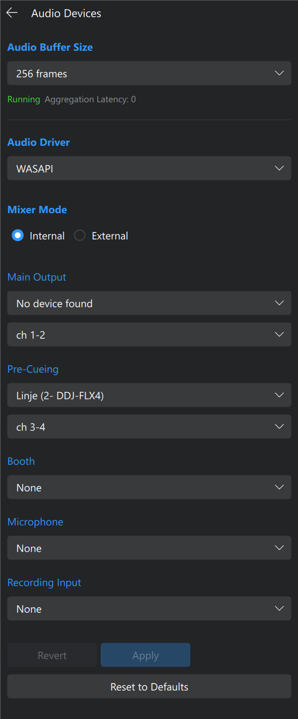

Hi all! I also started facing this issue. I use FLX2 on windows 11 and it’s just exactly as described here. Unable to select audio output, only for main channel but ok for pre-cueing . I detected this issue on Friday, August 1st.
Not sure why! Was it for a firmware update??
Hi @Missael.mape, welcome to the Community! Thanks for the information. Can you please confirm your djay version number?
Djay Pro version: 5.4
Windows version: 24H2

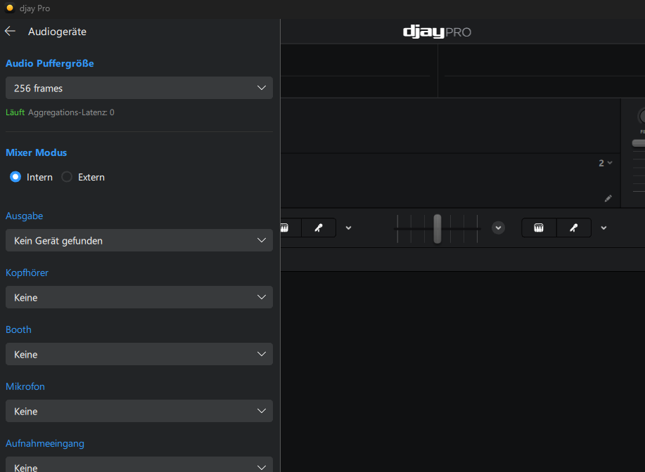

I can confirm this. No audio device is found. It still worked with the last version 5.3.x.
Windows 11 Pro 24H2
DJay 5.4.1

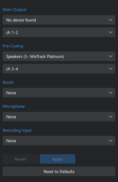

I’m also facing the same issue. Under “Audio Device” it says “No device found” but it’s fine for “Pre-Cueing”. I have also tried to reinstall the app, ran all Windows updates and updated all audio drivers. My controller is connected by directly by USB-C and I have also tried different USB cable and ports. I detected this issue on Sunday, August 3rd. It was working fine before that, so I was really baffled when it suddenly didn’t detect any audio device on the main output. I tried the controller on the Djay Pro phone app and it worked fine.
You can see my details about my setup and I have also attached picture below.
Device Model: Lenovo Legion 5 Pro
Version of operating system: Windows 11 (version 24H2)
Hardware/controllers used: Pioneer DDJ-FLX4
Hardware Firmware Version: 1.06

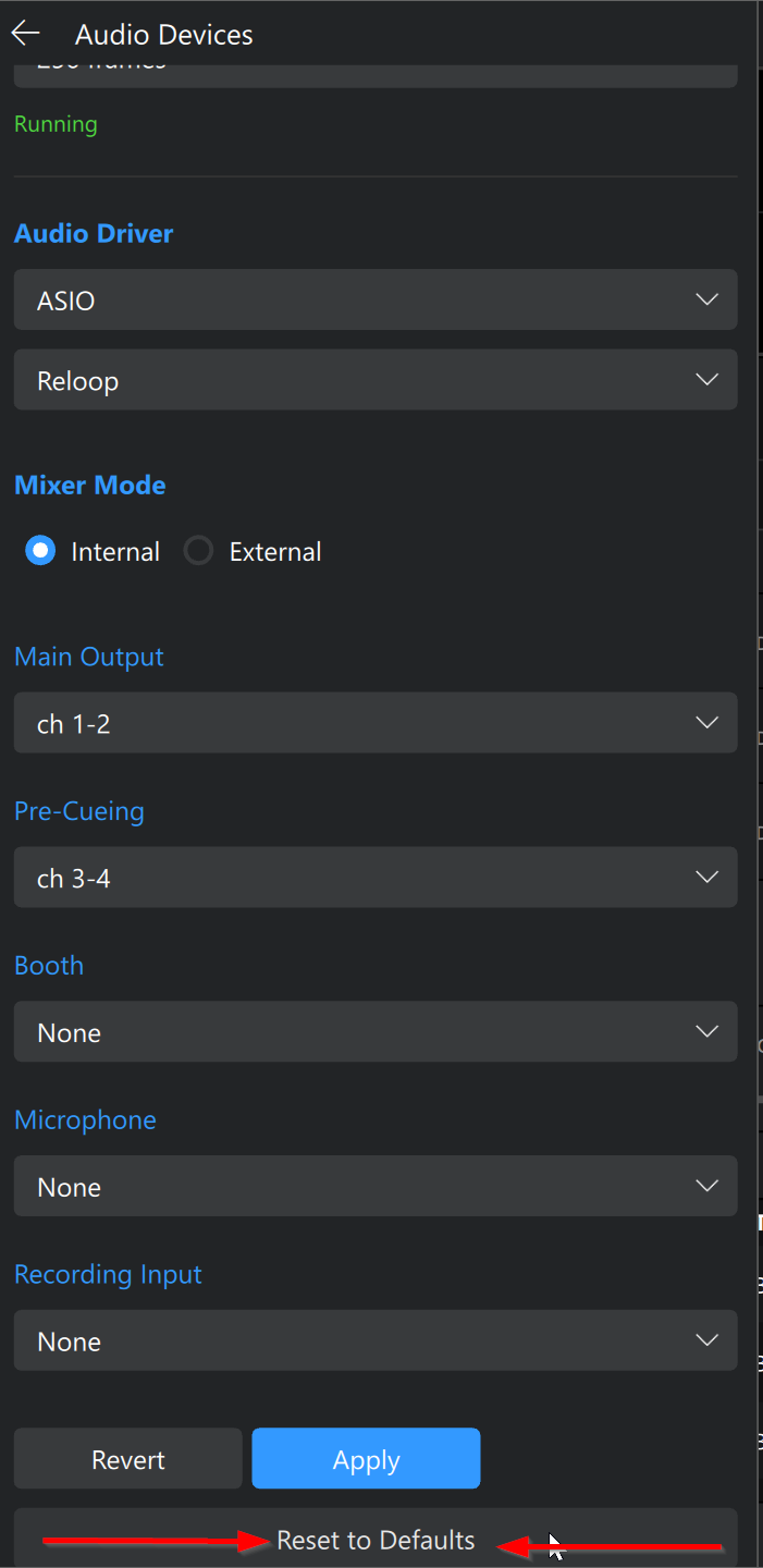

In the meantime, this is a purely UI bug. You should be able to use the “Reset to Defaults” button at the bottom of the menu to at least get the default Main Output Device.
