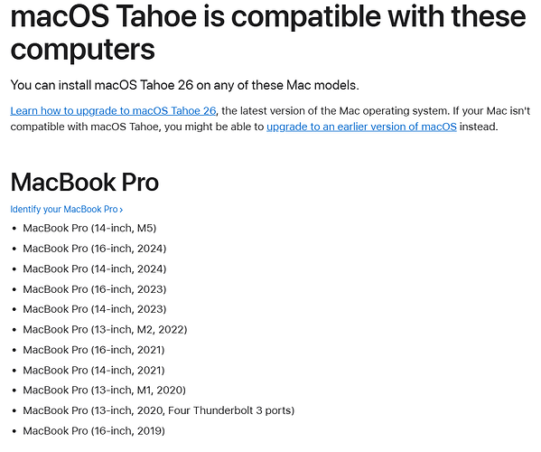

Hi again @Hans_Mulleur, we checked the Apple Support page and it looks like you 2017 MacBook Pro is not supported for macOS Tahoe 26.4. Can you please downgrade your macOS to an older supported version and confirm if this issue persists? Thanks!
Hi Slaw_Jaw, many thanks for the feedback. I have just checked my MacBook Pro and it is 14” 2021, Apple M1Pro. Apologies for stating that it was a 2017 MacBook Pro.
