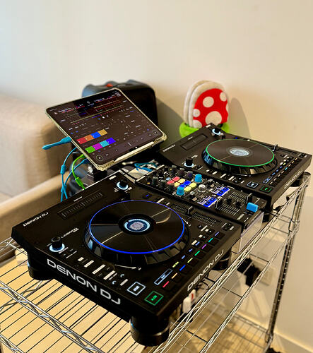

I used to have a Mixon 8 Pro and really liked it. Very tight integration with djay. I also had a Denon Prime 4 that worked great with djay on iPad. Currently, I have a Mixtour Pro with 2 Denon LC6000’s. I really like this setup a lot.

Awesome! That’s a clean setup! Very Nice!

Thanks! The LC6000s are great. You can actually control 4 Decks with a single player if you want. Plus the Mixtour Pro can control 4 Decks.

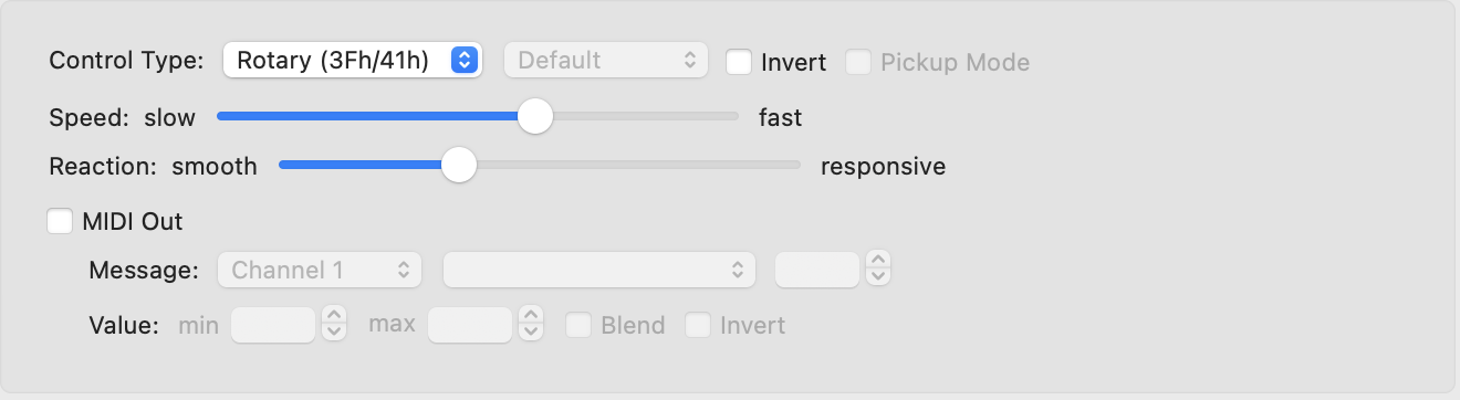

Are there maybe some advanced MIDI settings for the jogs/platters you can play around with? I’m not familiair with those exact settings, but I can imagine that maybe there is some resolution or speed setting you can tinker with?
Here are the MIDI Mapping settings for jogwheels
It might be that increasing the speed and/or reaction settings might help to get a better response:

Awesome! I’ll check this out when I get home! Thanks @olafmol @Slak_Jaw Much appreciated!:saluting_face:
