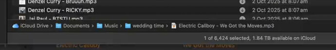

If I drop a new mp3 into my collection while djay pro is already running, it will add it to library, but be unable to analyse or play the track. but if i drop it directly to the deck from finder, it works fine. video attached. if I re-open djay pro, the track will then play - not an ideal solution

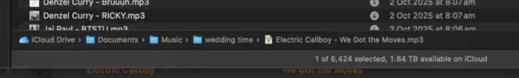

Hi again @jpb83, based on your video it looks like your files are stored in iCloud Drive. Do you have any files stored on your internal drive and does the issue also occur with those?
