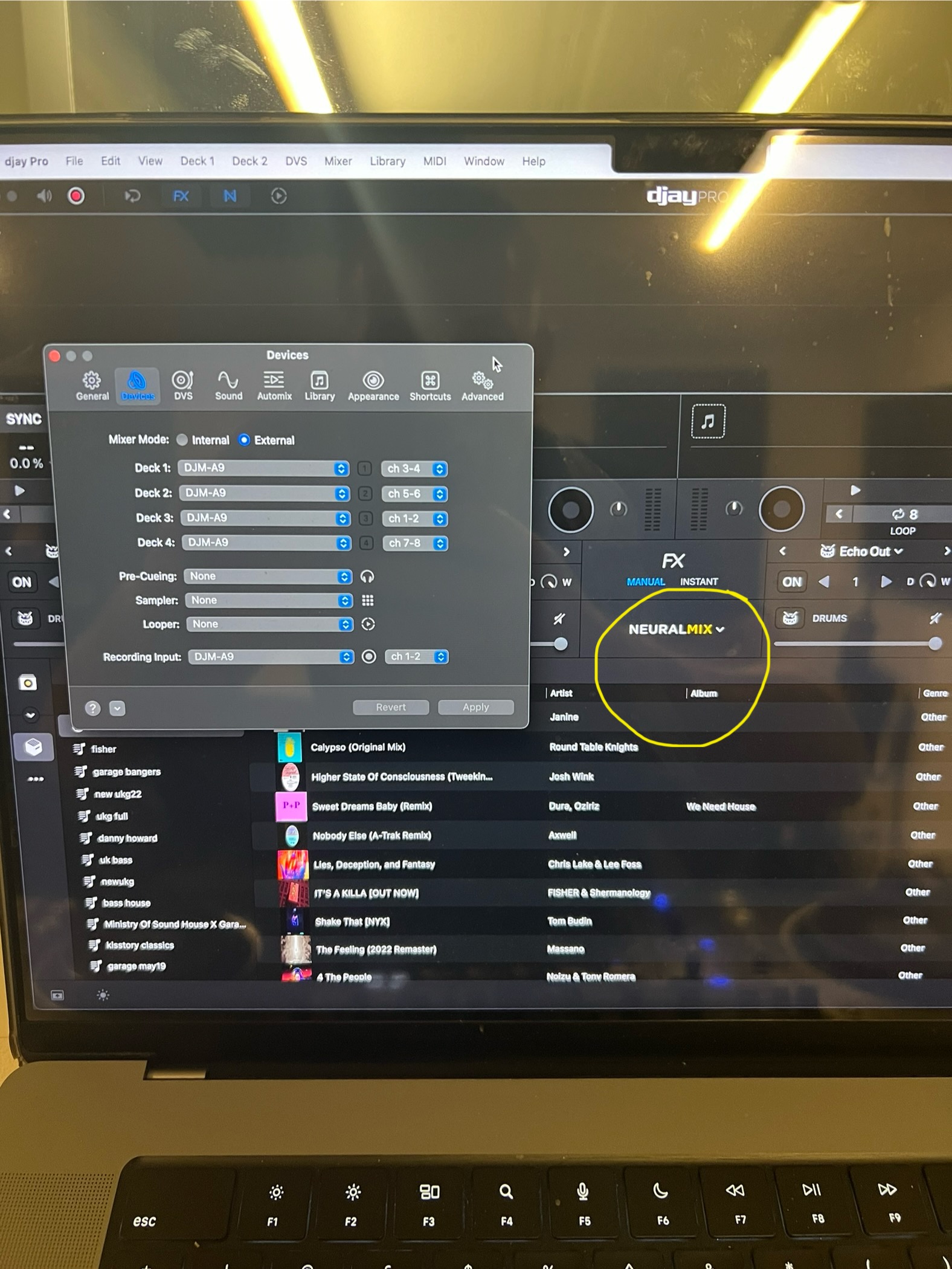

Hey thanks for picture but I have already selected that and when I do the crossfader fx and fader disappear. It’s only visible without the mixer connected. Is the djm a9 supported for this function?

I have tested with my own gear X96 with 5k iMac, and that drop down arrow appears - Do some restart, re-plug or something, that should be there. But don’t worry about CFX, currently doesn’t work well, its buggy enough.
Thanks for your picture. I have tried everything and it just doesn’t show the same as yours. Mine doesn’t show external mixer in the middle. l can only assume it doesn’t work with the a9 or there’s some kind of bug, Apart from that it all works perfectly.
