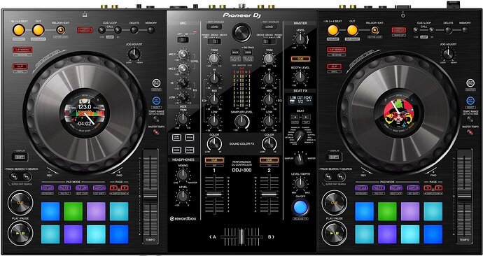

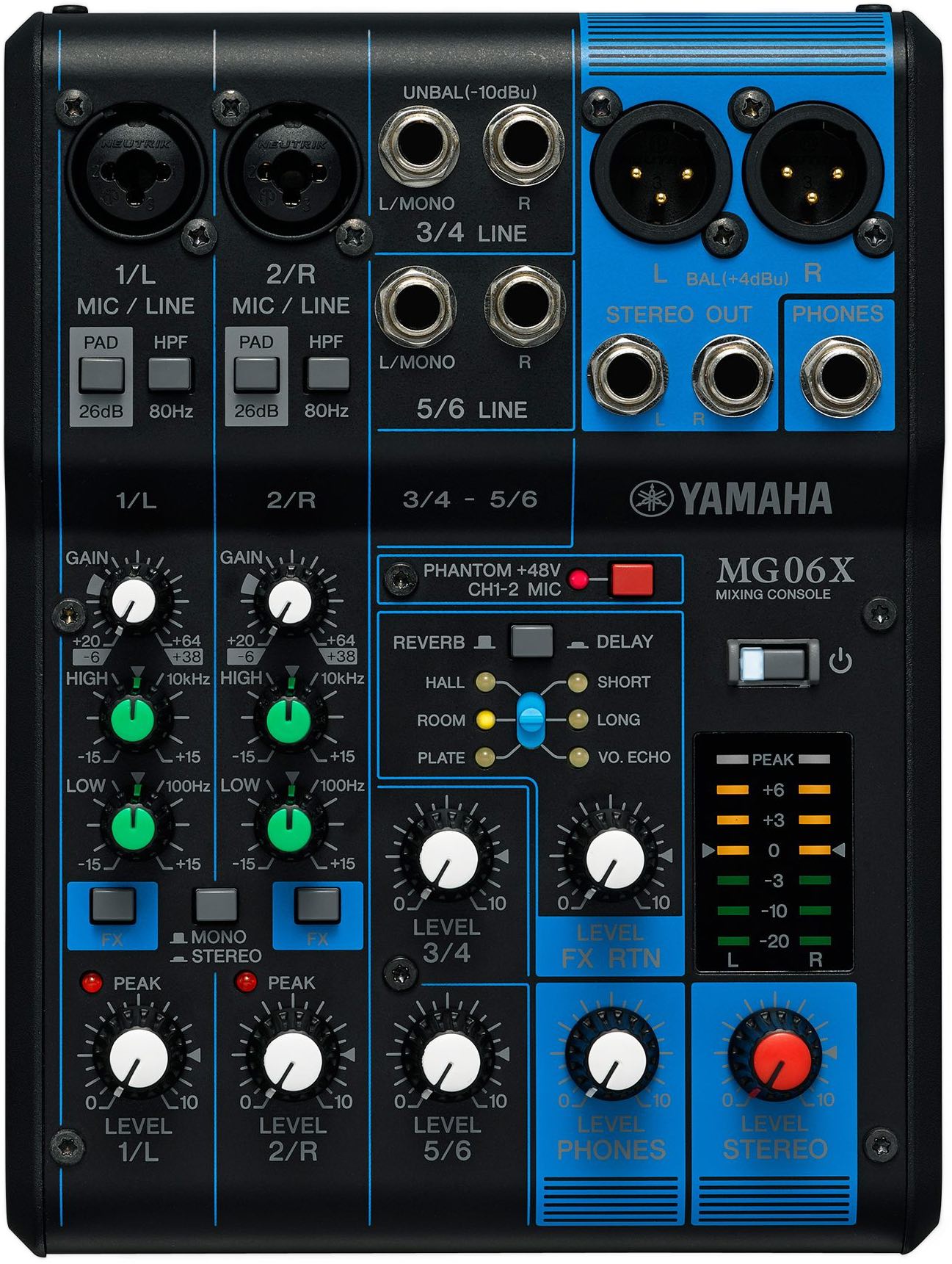

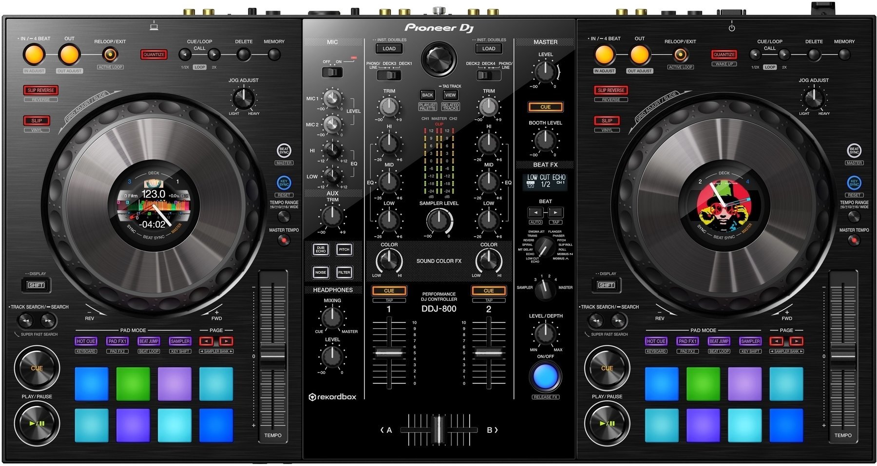

My idea would also have been the DDJ-800. Nevertheless, I always recommend using an external mixer. It gives you more connection options and the audio components are often better than what is built into standard controllers. I myself use a Yamaha MG10 XU.
use the ddj 800 with djay pro?

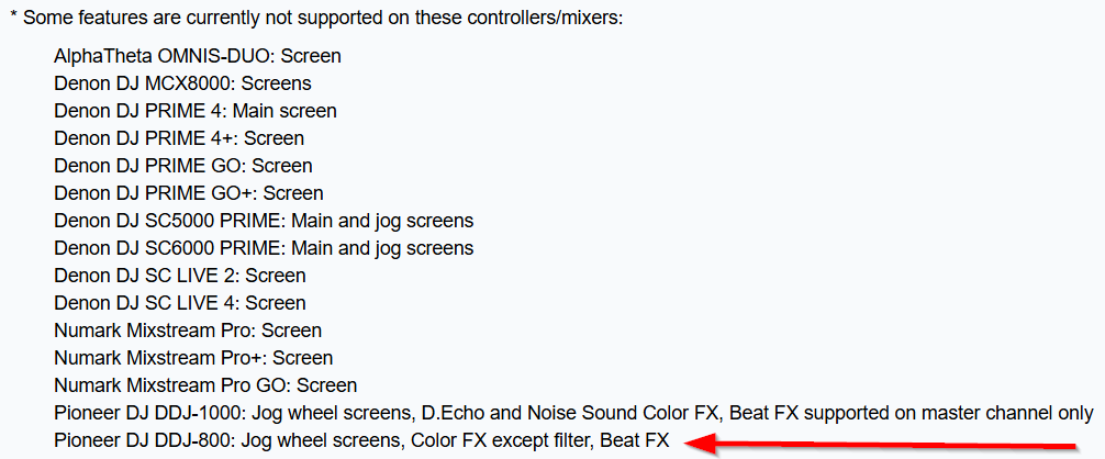

Hi @jenoux, the Pioneer DJ DDJ-800 is supported on macOS. Please see below for features that are not supported with this hardware.
I have some doubts, the compatibility is not complete, born in 2019, it costs a lot of money … isn’t the Rane1 better for example?
Hi @jenoux, the RANE One is also supported on macOS and is definitely a more modern device. I suspect it is heavier and less compact though.
Beat FX are now working on DJay Pro on the DDJ-800.
This was added in the last DJay Pro update.

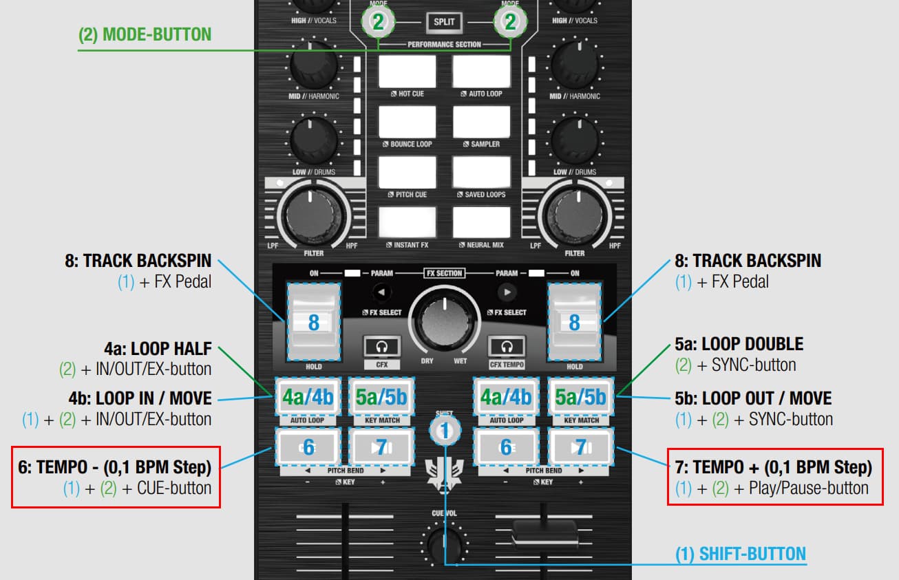

Reloop Mixtour Pro + Mixer?
How do you use it without a deck?
With prepared tracks :wink: What do you do with the decks? If you’re not a scratch DJ, many people use it almost exclusively to move to the playback position within the tracks. And this can also be achieved very well by setting appropriate cue points.
You use sync, the onscreen jogwheels, onscreen tempo faders, onscreen nudge controls, or the hidden tempo controls on the hardware:
