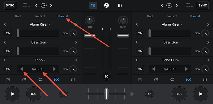

When going to the FX screen I can set Echo to 1/4 BEAT. However it seems too much of a hassle to get there and use this on my tiny phone screen to do this as shown here:

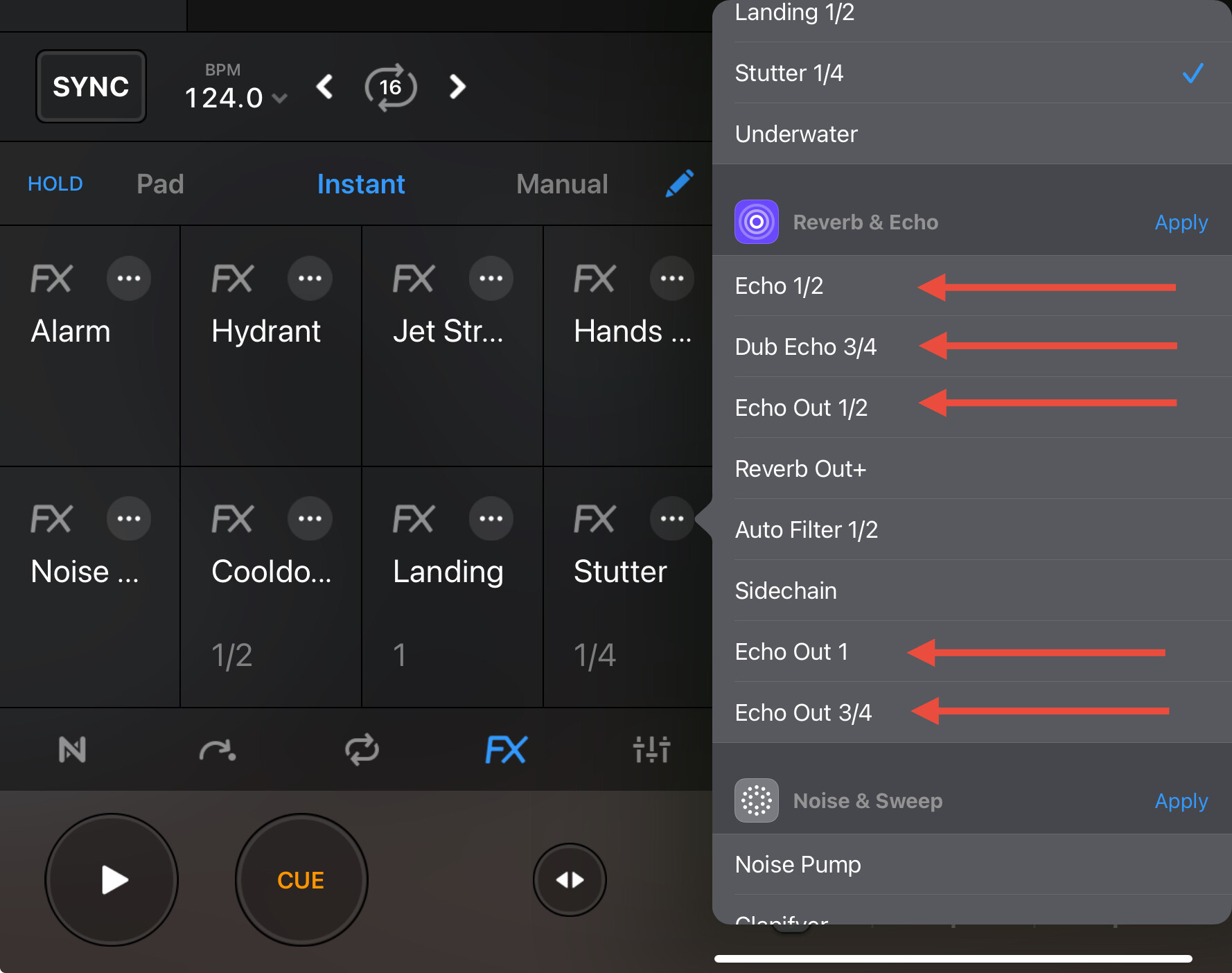

If I go from the Manual to the Instant tab I find the Echo Out+ which is also allocated to a button on pad on my Hercules Ultra, however this one has a 1 beat assigned to it an and I can´t seem to find out how to change this to 1/4. Please help me here and please, if possible, let me know how to apply the effects as shown in the instructions video I am watching.

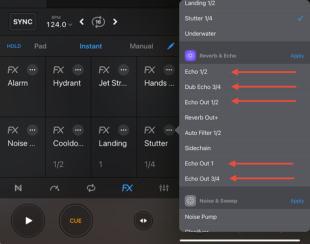

Hi @sandfish, the Instant FX Echo values are fixed and cannot be adjusted. While we do not have an Echo 1/4 option available in Instant FX, we do have Echo 1/2, Dub Echo 3/4, Echo Out 1/2, Echo Out 1 and Echo Out 3/4. Perhaps one of these options will work for you.

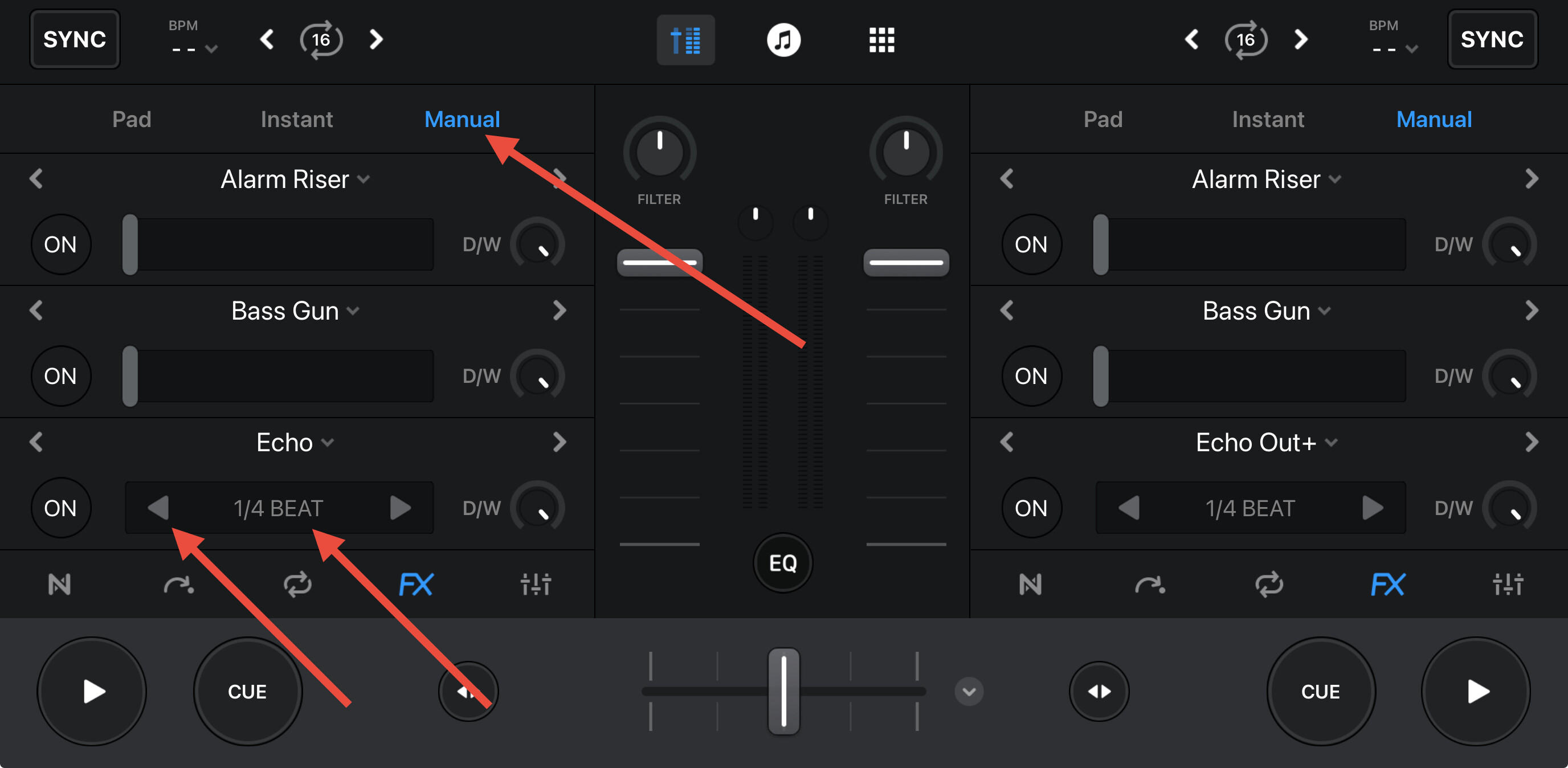

Alternatively, if you want to use the Manual FX, you can set the Echo value to 1/4 using the arrows. As long as you don’t change this before you close djay, the next time you open the app, it should already be set to 1/4.
