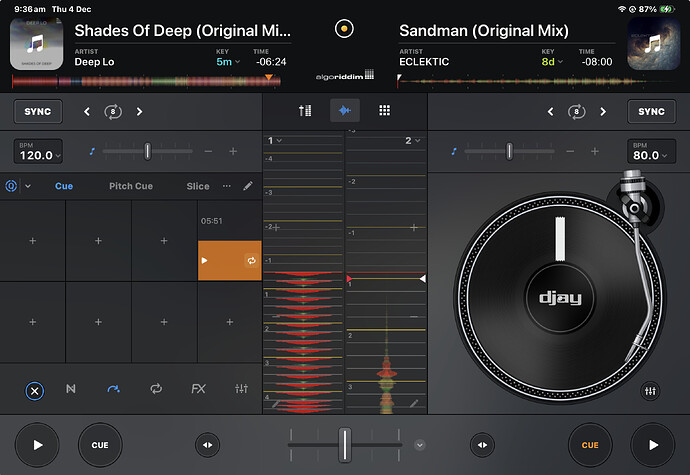

I formatted my flash drive for OneLibrary within Djay, synced all of my tracks over and then brought it to a CDJ-3000 running version 3.30. Everything worked perfectly, and I ejected my flash drive after a set and brought it home. Later, I plugged it into my iPad, only to discover that the first 3 cue points were missing from every single track! I would assume this is probably due to the buggy nature of the 3.30 update, but I thought I should share since it’s a pretty interesting and consistent bug.
On the left is the track in My Collection, on the right is the same track on my USB:
Thank you! This re-confirms the need to avoid using USBs on a CDJ-3000 with the 3.3 update.

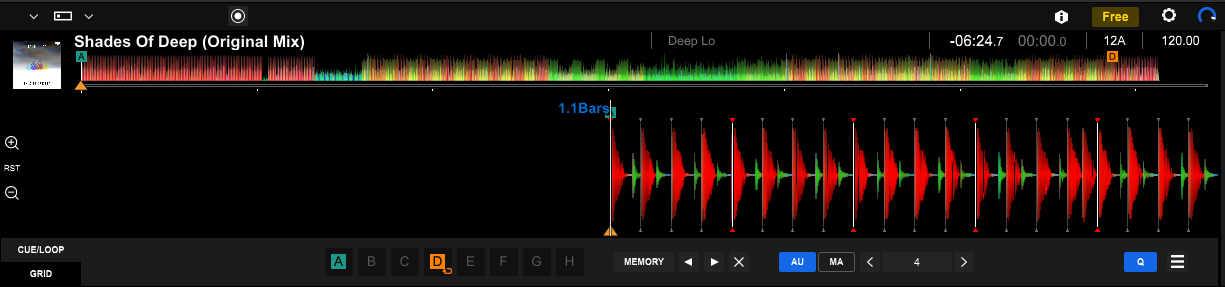

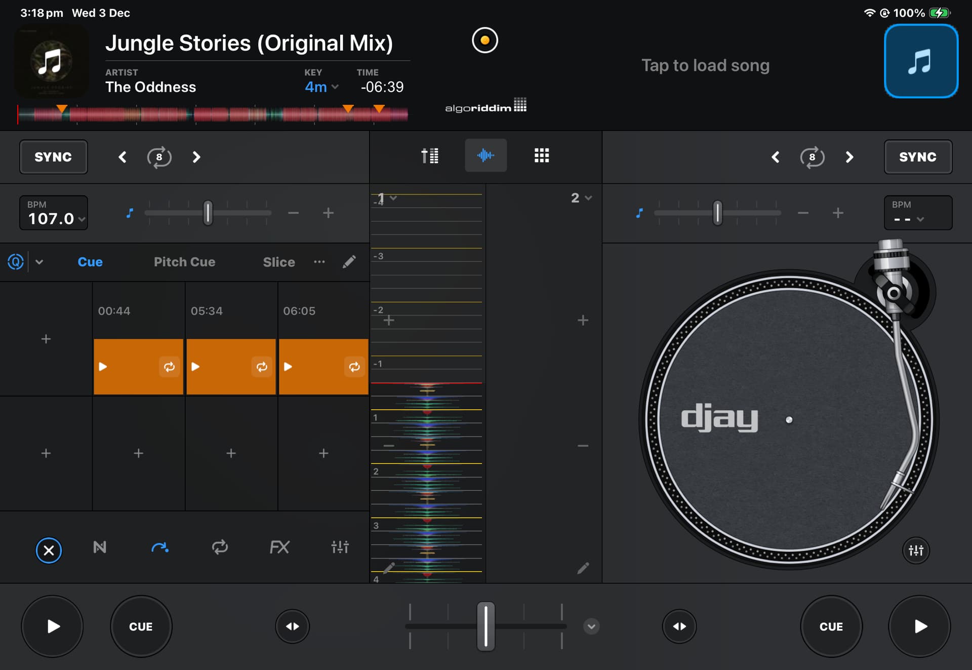

Many of the songs on my OneLibrary USB are missing the first cue point which is always at the very beginning of the track.
Sometimes DJAY also seems to put the downbeat on beat 3 when it should be on beat 1.
The songs I am exporting all have the first cue point…
Wondering why this is happening? Is it a bug with OneLibrary or is there something I can do to avoid this issue?

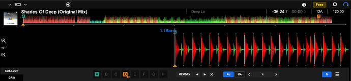

Here’s the file for the pics I posteed above

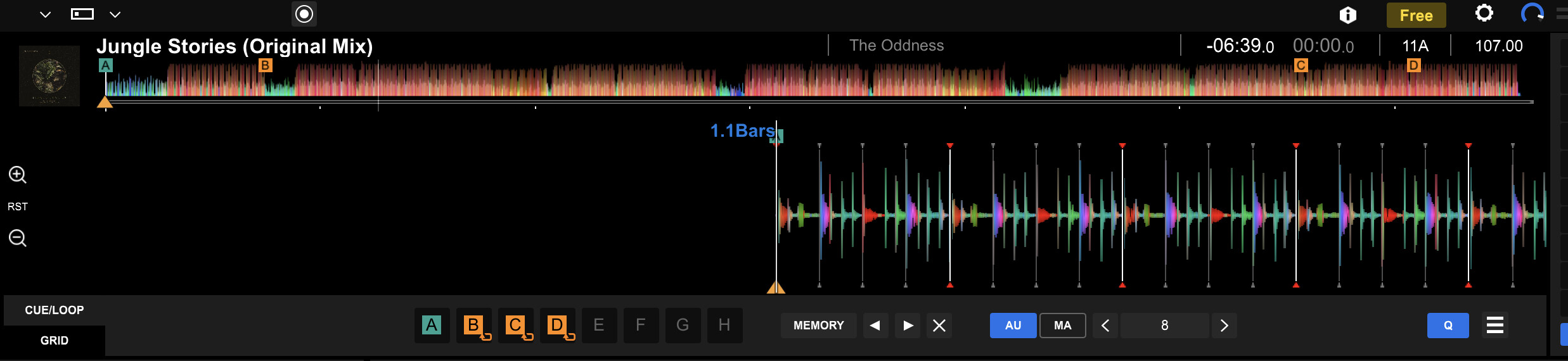

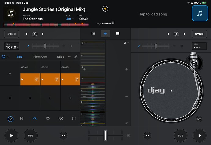

Here’s another example…
Rekordbox: Cue point 1 is on the first beat and downbeat on beat 1
DJAY:
Cue point 1 is missing
Downbeat is on beat 3

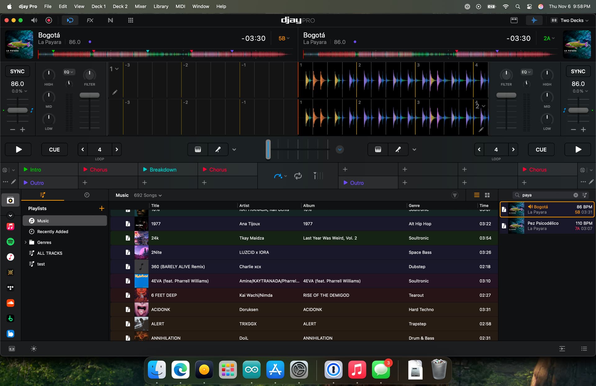

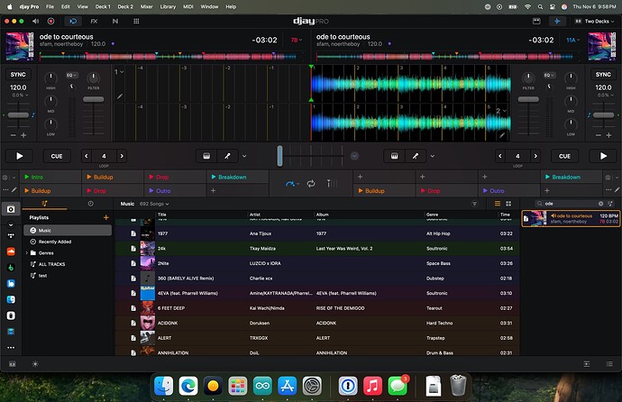

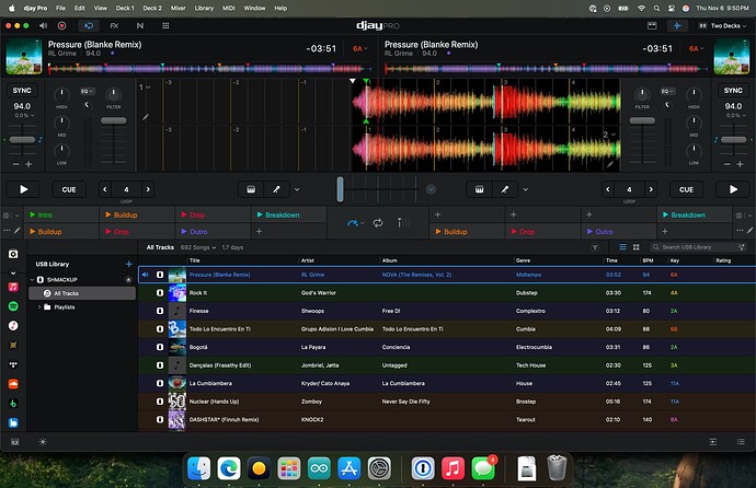

Video of both bugs: https://www.loom.com/share/d45cbea0d85f41d7a3a2c181a27a38c8
2 issues:
Playing from RB playlist into Djay Pro.
  1. Hot Cue A is missing occasionally.
  2. All hot cues are green while in RB they are multicolored.
  1. Drag songs into RB playlist and analyze with hot cues.
  2. Open Djay Pro and look at the playlist
  3. Issues are there.

–UPDATE–
I exported the playlist to USB, accessed the playlist through the OneLibrary flow, and found the colors propagated!
However, hot cue A is still missing.
See video for context:
It would be ideal if I did not have to export to USB first to get access to the hot cue colors as well as have hot cue A export properly.
Thank you again!

  1. MP3s
  2. Attached 2 files with screenshots of their hot cue issues (all green and missing the first hot cue).
  3. Attached.
