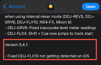

Have updated to the 5.4.1 im about testing now
Perfect! Everything should be working as expected now.

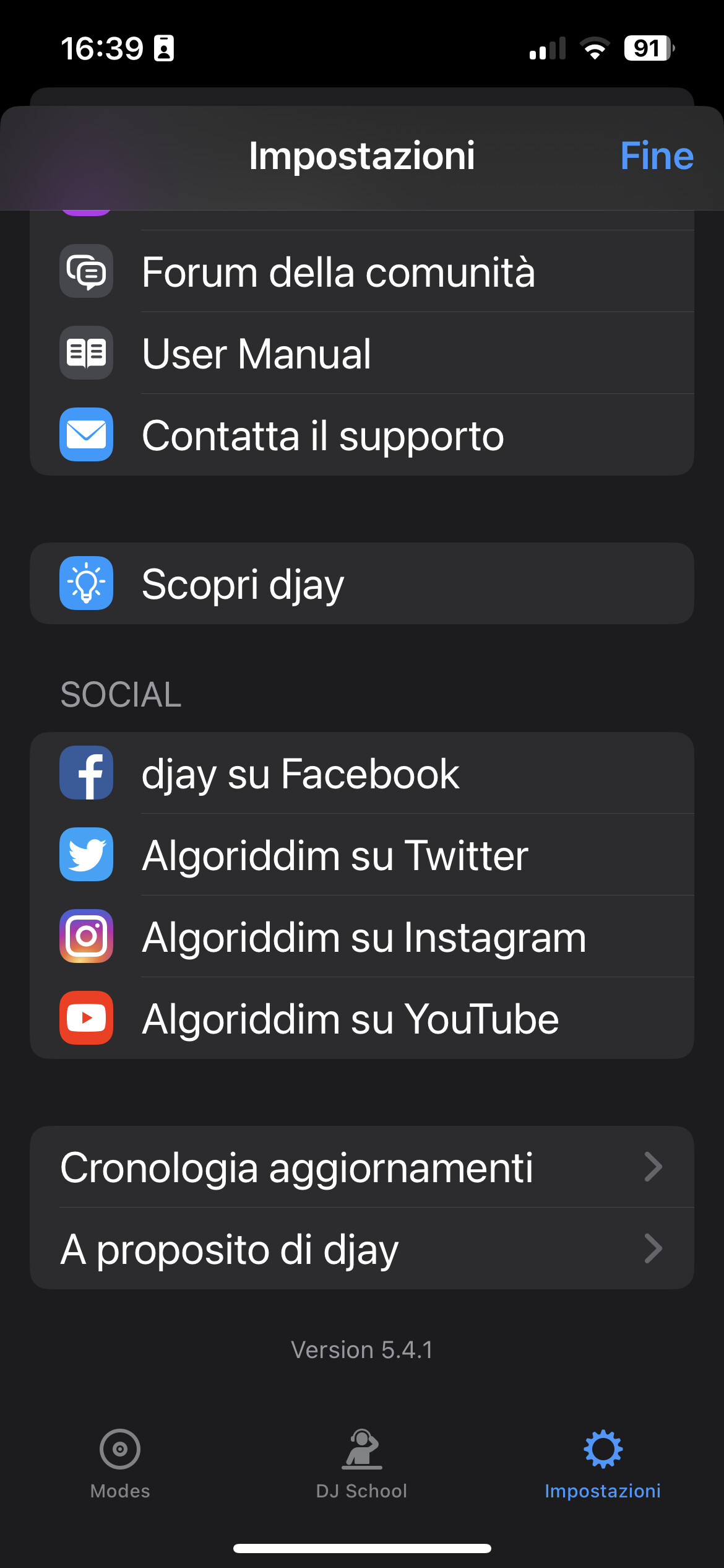

Djpro dopo l aggiornamento non mi va più con iPad Pro su l flx 10 !qualcuno ha lo stesso problema?
After the update, Djpro no longer works with the iPad Pro on the flx 10! Does anyone have the same problem?
Hi @gianpy_torres, please use search before creating new topics. I have merged your new topic with this existing one. Please update djay on your iOS device to 5.4.1 to receive the patch for the FLX10. See above for more details. Thanks!

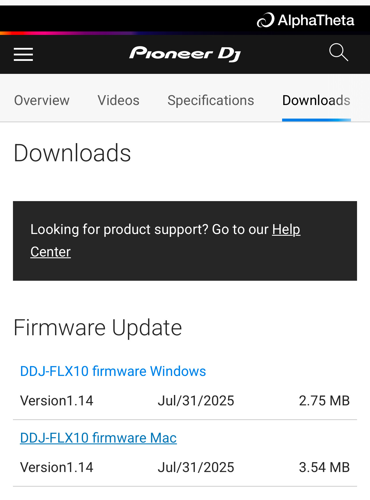

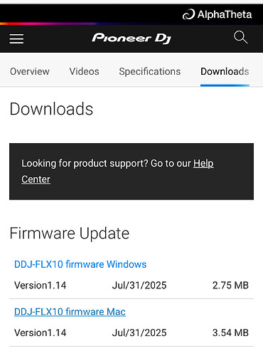

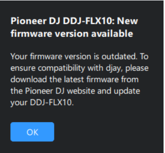

Please update your firmware from the Alphatheta site. The staff forgot to mention this in this thread. The firmware specifically has to do with DJay pro and the FLX10.
Thanks for sharing @OneCrazyDJ. djay should automatically prompt you to update the FLX10 firmware after updating to djay 5.4 and connecting the FLX10.

  1. Have you updated the FLX10 firmware to Version 1.14 on the Pioneer DJ site? DDJ-FLX10 Support & firmware download - Pioneer DJ USA

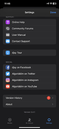

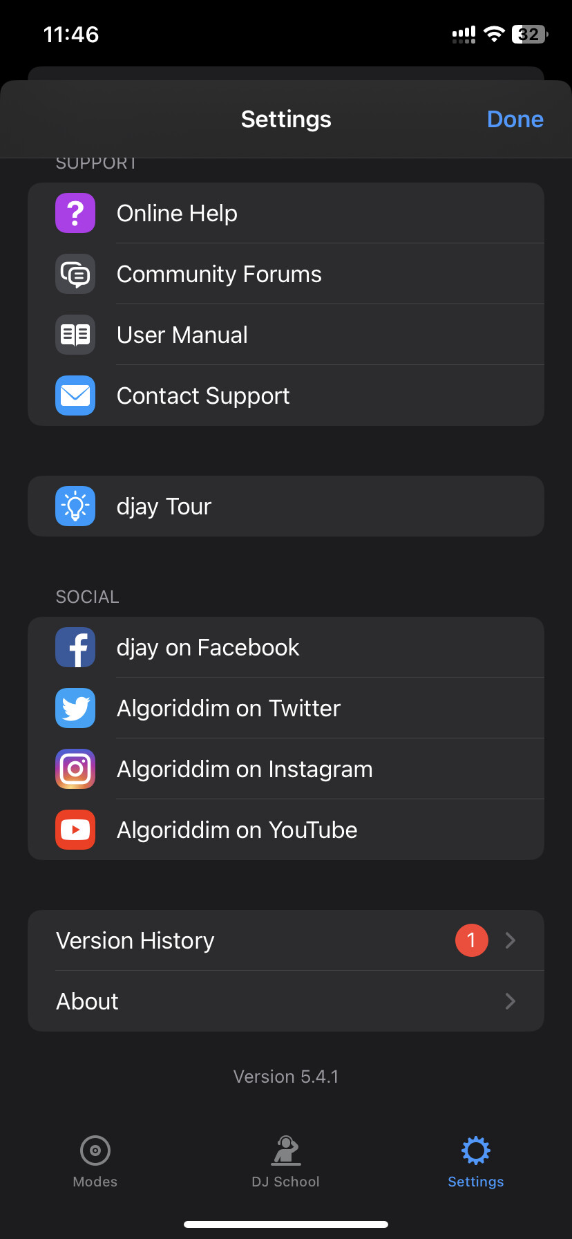

Device Model : IPhone 14
Version of operating system : IOS 18.3
Version of djay (ex. 5.1.3): 5.4.1
Hardware/controllers used : FLX10
Hardware Firmware Version :1.14
Connection: charging and data cable usb-c/lightinig

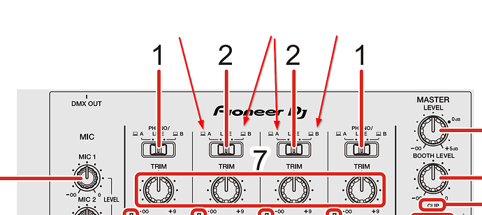

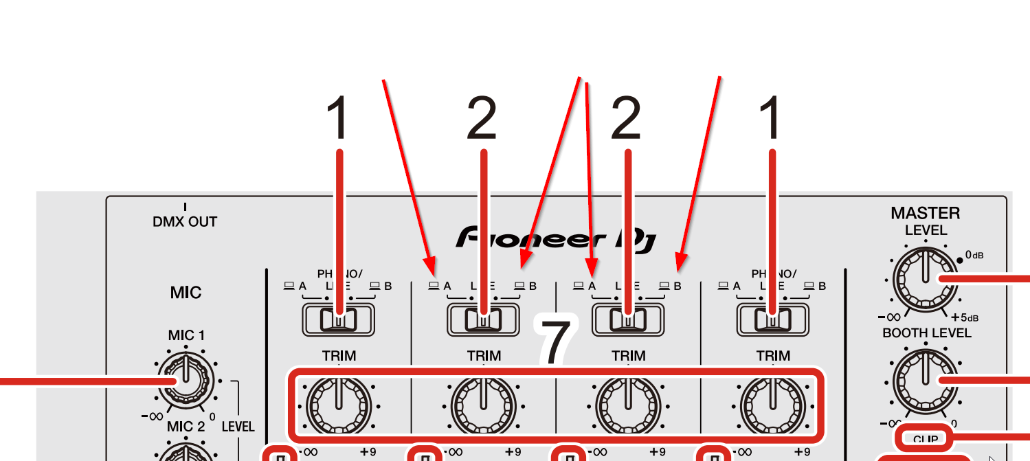

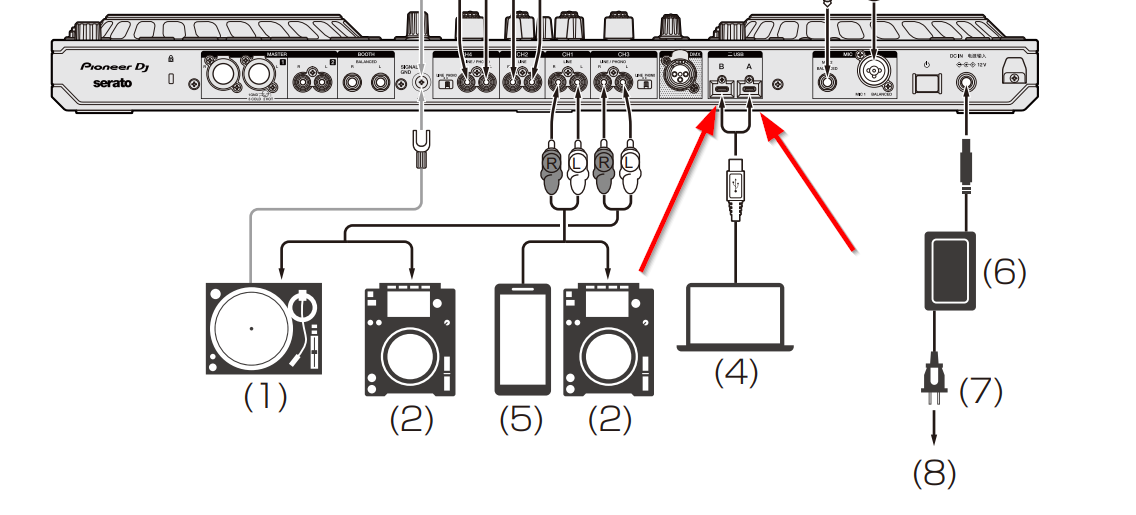

@Randal please, make sure the USB-C socket you connect to on the back of the device matches the source selection switches above each channel. If you use the A socket on the back, make sure all 4 source switches are also set to A on the top of the FLX10.
